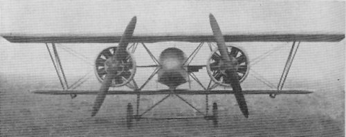

The real mystery are the three 'D' series fighters - I've seen references, but I've never seen drawings or more information.
Caspar D.I and Hansa D.I are probably the same aircraft. Caspar D.I entry and image from 'German Aircraft of the First World War' by Peter Gray and Owen Thetford, Putnam 1962:
Designed by Karl Caspar, this twin-engined, single-seat fighter was built by Hanseatische Flugzeugwerke in late 1918, but the machine crashed on its first flight. Engines, two 100 h.p. Oberursel U I rotaries.
Entry from 'Typenhandbuch der Deutschen Luftfahrttechnik' by Bruno Lange, Bernard & Graefe 1986:
Hanseatische Flugzeugwerke, HFC, Karl Caspar AG, Hamburg-Fuhlsbüttel
D-Typ, Versuchseinsitzer, 2 x Oberursel-Umlaufmotoren. Doppeldecker, Motoren mit Zugpropeller zwischen den Trägflachen, konstruiert von Ing. R. Geringer. Beim Probelauf 1917/18 brach ein Motor heraus und verletzte einen Monteur tödlich, die Entwicklung wurde abgebrochen.
Single-seat experimental, 2 x Oberursel rotary engines, biplane, engines with tractor-propellors between wings, constructed by Ing. R. Geringer. In a 1917/18 trial-run one engine broke free and mortally wounded a mechanic, development was abandoned.
Thank you for the marvelous information! I was very much surprised to see a picture of the D.I

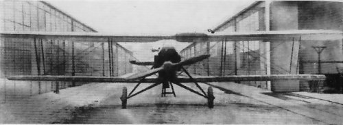

Image of the Ago S1 anti-tank aircraft.

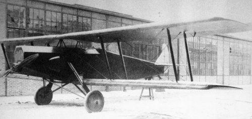

Images from Gray/Thetford.
