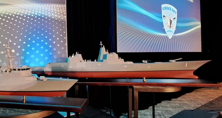

So to summarize: installing the reactor into assembled hull would not actually took much of shipyard resources, and likely could be performed without affecting carrier construction?
When NE Savannah was built the engineers made her as civilian friendly as possible. Her reactor was house top and machinery in engine deck was to the side. And reactor simply popped out by draining the pool 1000042879.jpg
