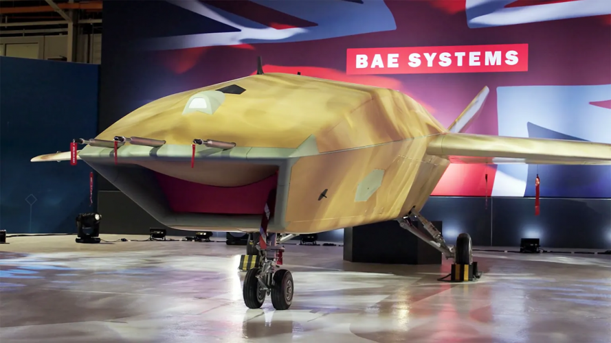

The inboard control surfaces remind me a little of the F4D Skyray's pitch trimmers. These were essential in providing enough pitch authority on landing at high AoA (which is how a delta like the Skyray could fly at slow enough speeds to land on carriers).
So in this case the outer trailing edge surfaces might pitch down slightly to create more lift for short landings, while the inner surfaces pitching up slightly to keep the aircraft trimmed on approach?
To me, it looks far more like they got most of the way through development and build and then realised they didn't have enough pitch control power so their only option was longer chord inboard surfaces...
Not enough pitch authority? Shocking. Who'd've thunk it.
