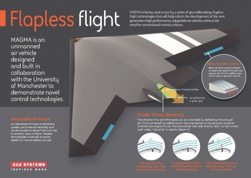

Are there any published dimensions for MAGMA or even ga type drawings ? B)
