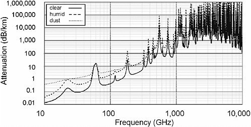

Consider the atmosphere absorption of terahertz frequency, any radar working with that frequency will be quite useless for air defense purposes.
And the so called photonic radar is probably mostly marketing hype, it is very unlikely to come here anytime soon, we probably only have them once B-21 already retired

Terahertz radar's biggest problem was creation of components such as waveform generators and waveguides not necessarily its attenuation in atmosphere. It's a very useful waveband due to its high detail, and with use of pencil beams its range can be quite high plus its high accuracy and near immunity to RCS reduction.
No, the biggest problem of Terahertz radar is exactly atmosphere attenuation. The absorption rate at 1 THz is literally 10,000 dB/km and dB unit scaled exponentially, in other words, every 1 km that the signal pass through the atmosphere, the signal strength reduced by 10^1000, can you even imagine how big is that number? you would be lucky if your THz radar can see past the 10 meters range. And why would THz radar be immune to stealth? the wavelength would be too short that all reflection will be specular reflection, literally the type that stealth aircraft most optimized against

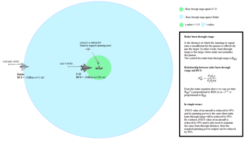

This discussion has so far also omitted any references to how much more effective any ECM will be with a smaller target reflection. Perhaps you get a fleeting glance and can focus your energy in that area, but with a modern aircraft that is unlikely to not go unnoticed and might provoke active countermeasures.

The THz frequency is valued because it's almost like laser and giving you a very fine resolution, this allows you in field of industry to spot a small cracks (tho there is X ray for that but i guess cant always bring a large X-ray machine) Or in terms of RCS testing. This allows much smaller subscale model to be used.
The possible means for "counter stealth" with THz however looks enticing as it's basically allows you to see more imperfections thus spikes. Though atmosphere may work heavily against you, but one can find a "window" frequency where the absorption is smaller, plus expect RAM against this frequency to be more easily implemented as it would be thinner. In short, you may not get sort of useful range unless you're stealth yourself and more stealthy than the one you hunted. It may have missile seeker application but that's gonna be far in future. Another problem is getting enough power. Higher frequency transmitter tend to have rather small power generation capability and difficult to build. If you want a phased array, it cant be AESA as its gonna need thosands or even hundred thousands of elements to fill even modest aperture (e.g missile seeker)

Really? Considering until recently Thz devices were practically lab based, "existing" was the biggest problem for it. Second of all, yes attenuation is enormous at THz range, yet still being worked on for radar/imagery, due to the fact that THz doesn't care at all shaping, I fail to see how stealth aircraft would be "optimized" against Thz.
All THz devices are labs based because the sheer idea of using THz radar for air defense purposes is even less practical than using a toy water gun to intercept ballistic missiles.
"Enormous" is still a massive understatement when talking about the THz absorption rate of the atmosphere. So let me put it this way for you: Atoms are very very small while the universe is very very big, but it is estimated that there are only 10^78 to 10^82 atoms in the known, observable universe. Compare that to the number I gave you earlier, every km that the signal of a 1 THz radar pass through atmosphere, the signal strength will reduced by 10^1000 times. So unless you want your radar to have maximum range of 5-10 meters forget about THz frequency.
And THz care a lot about shaping, even more than the common X-band since at 1 THz the wavelength is barely 0.3 mm, so most if not all features of the stealth aircraft will be in optical region for a THz radar.
