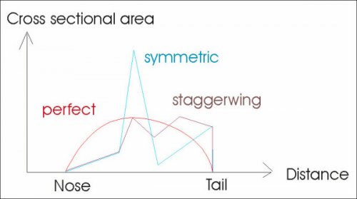

Wikipedia says: "To reduce the number and power of these shock waves, an aerodynamic shape should change in cross-sectional area as smoothly as possible. This leads to a "perfect" aerodynamic shape". Here is my interpretation for the Eagle:
Tophe said:
Just call me Ray said:
Tophe said:
Sorry, I think it is rather wise, think of the area rule...
http://en.wikipedia.org/wiki/Area_rule
I still don't follow how the asymetric wing design helps in that regard.
See, I get that much, but in your first post you didn't explain the how of that works. It's like explaining to someone that computers run on binary but not explaining how the 1s and 0s work. Well, the little chart helps at least.
