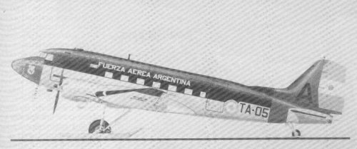

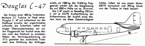

Does a picture exist to confirm this sketch of an Argentinian Air Force C-47 fitted with an additional Turbomeca Marboré 2C (from aero April 1965)? Or was it an April joke?

Hello Boxkite!
Is not a joke. That is the TA-05 the first Argentine airplane that reached the South Pole in Nov 3 ' 65. In addition to the Turbomeca Maboré II of 400 kg of push for the takeoff it used a JATO rocket battery . Propellers, reactors and rockets in same plane! Flew additional 200 hs before being retired in the ' 69, at the moment is in the national museum of aeronautics of Buenos Aires.
Greetings
(souce of pics and information: "Aeroespacio" magazine 469 and 492)
More info: http://www.marambio.aq/escuadrilla.htm

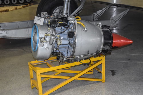

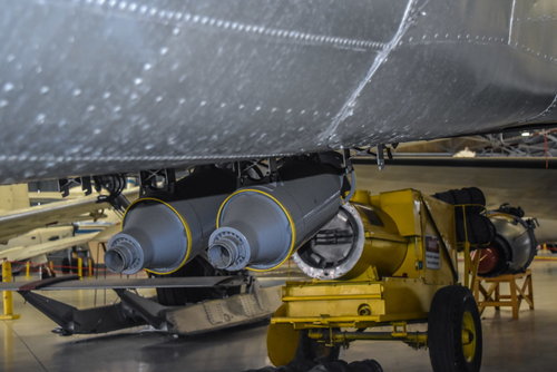

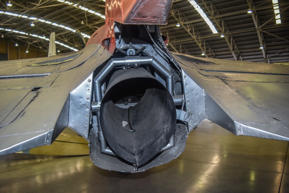

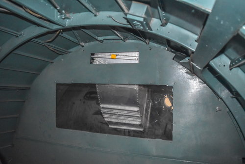

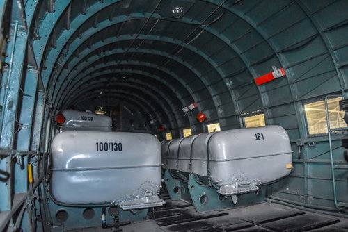

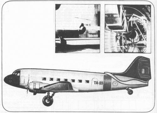

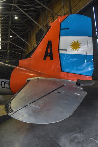

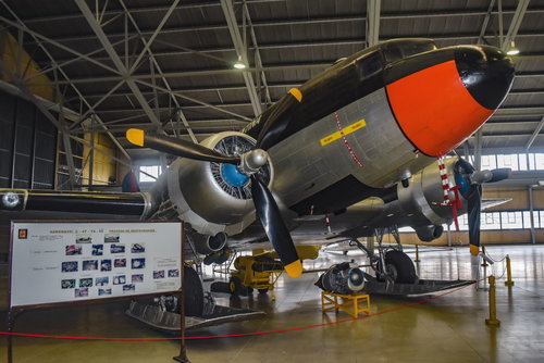

Hi everyone, here are some images of TA-05 at the MNA in Buenos Aires. A number of years ago I was given a tour of the museum by one of the guys involved in its restoration and snapped a few images. To add to the pictures, you can see the ad hoc nature of the installation by examining the exhaust from the exterior. Note that the hori stab has had local strengthening applied. Within the interior a cutout has been made to show the intake ducting and location of where the Marbore sat. You can see the exhaust outlet at its end. Note the extra fuel tanks within its interior, with avgas and avtur tanks thus marked, leaving little room for any reasonable sized cargo. There is also a close-up of the RATO bottle installation on its belly.
