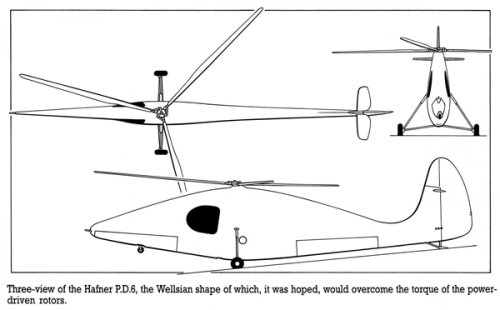

Ray Sturtivant's 'British Research and Development Aircraft: Seventy Years at the Cutting Edge' has the 3-view of craft.
Sturtivant states that Specification 10/39 was issued to cover the project and the it was assigned serial T3005.
However, he gives no technical data.
Thanks for any info,
Jon

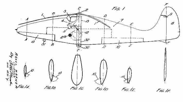

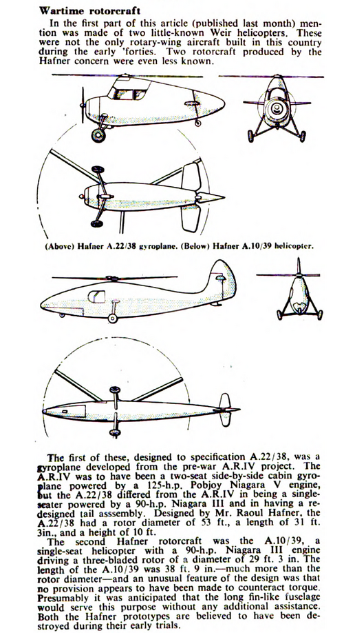

Haviland Platt and Dr. W. Laurence LePage collaborated on a similar layout for a single rotor helicopter in the mid-30s, Dr. LePage published drawings for what the High Speed Platt helicopter would have looked like.
I'll have to scan the image I have.
From Air Pictorial 1949.
