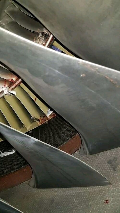

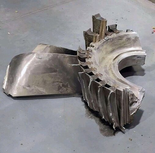

Seems to be birdstrike. That somehow break the fan and it starts spewing blades around.
Some images i found from my messenger group about the accident.
Trident
May 8, 2006
1,157
499
Probably going to out myself as a total engine nerd, but the first of those images is not a D-18T (swept fan blades without snubbers, swept core IGVs & metallic fan stator - the D-18T famously has composite stators). Also, it's not compatible with photos of the aircraft and in the link above and also not with the second image (which I believe is genuine). They indicate the entire fan rotor including disc was ejected (which explains why the failure was not contained) while the top photo shows it still in place on the engine.

The fan debris went straight through the fuselage - in on one side, out on the other :eek:
Unpleasantly suggestive of what could have happened to AF66 (where there would have been passengers sitting in the plane of damage)!
I think the flight crew deserves a strong drink!

Pretty sure the first pic is a CFM 56, per the comments on AvHerald: https://avherald.com/h?comment=4df212c7&opt=0
Yes, a -7B to be exact (the 5A/B-versions have snubbered fan blades and straight IGVs).
I did mention I'm an engine nerd.
yes, yes you did. :D
No longer so sure on that identification, for the record. The hub/tip ratio seems high for a CFM56, and the fan blades appear to have more sweep than on even the 7B-model. Originally I attributed that to the bird strike damage, but I'm leaning toward SaM146 now (which would at least make it a Russian engine...).

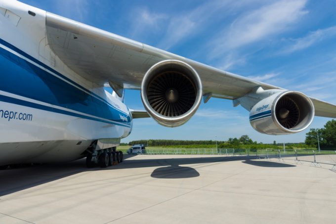

@Anduriel: As hinted above, Antonov is still flying (D18T) :
Notice:
Two of Volga-Dnepr’s aircraft were flying today, according to flight tracking websites. One appeared to be doing a test flight to and from Leipzig, while the other flew from Paris back to Volga-Dnepr’s base at Ulyanovsk.
