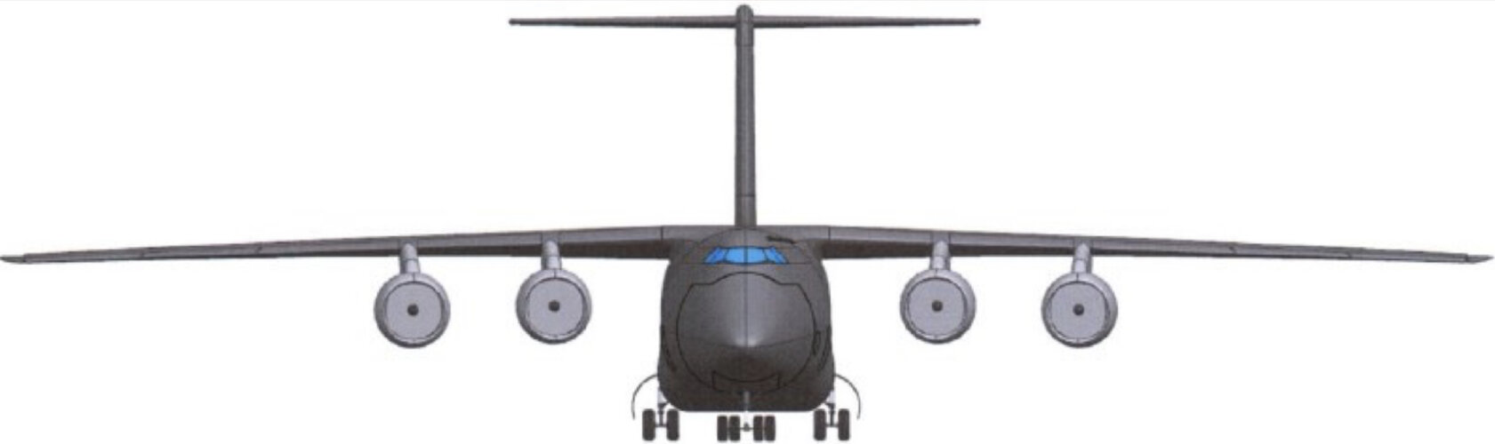

Russian aerodynamics researchers have unveiled a concept for a new heavy transport aircraft to succeed the Antonov An-124.

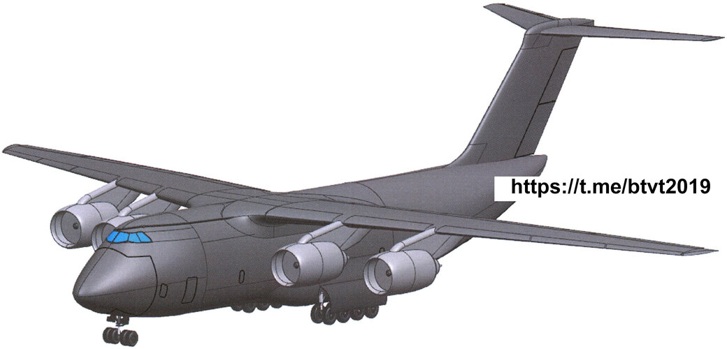

The aircraft has been tentatively designated 'Slon' – the Russian term for 'elephant' – and is outwardly similar to the An-124 in appearance, with a high-wing, four-engined layout, nose-loading capability and a low horizontal stabiliser.

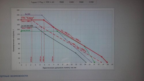

Moscow's Central Aerohydrodynamic Institute (TsAGI) states that the aircraft would able to transport 150t of freight over a range of up to 3,780nm (7,000km), operating off a 3,000m (9,840ft) runway.
But it would be able to handle a maximum commercial load of 180t – with which it could operate over a distance of 2,645nm.

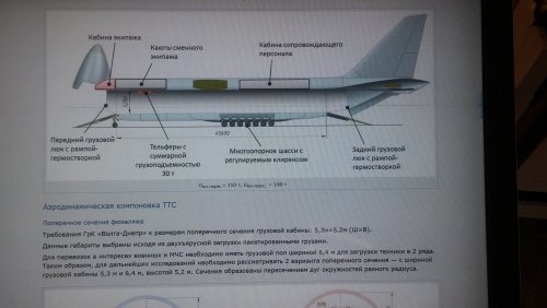

Images taken by flateric.
http://transural.egloos.com/m/318673
http://bmpd.livejournal.com/2742690.html

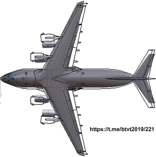

The dimensions (especially the 6,4m wide study) are far closer to the An-225 than the An-124, additionally supported by the use of 4 of the PD-35 engines in the 30-35 ton thrust bracket.

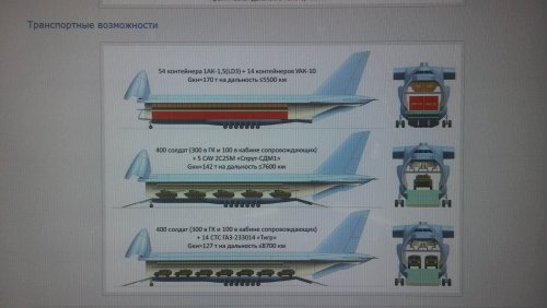

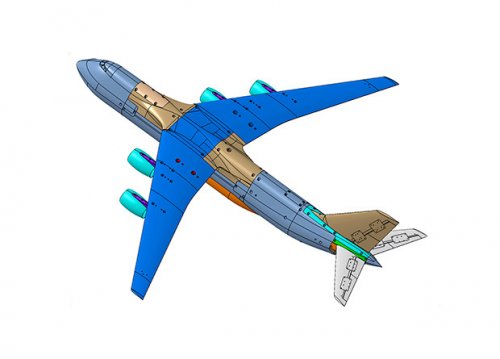

Specialists of the Zhukovsky Central Aero-Hydrodynamic Institute assembled an aerodynamic model of a promising heavy transport aircraft “Elephant”, which will be used for testing in a wind tunnel. According to the institute, the first purge test of the model is planned to be held in August-September 2019.
The “Elephant” project was first presented at the MAKS-2017 air show. It involves the development of a heavy transport aircraft, which in the future will make it possible to replace the aging Ukrainian An-124 Ruslan in the fleet of Russia, whose maintenance and repairs have become much more complicated and expensive because of political differences with Ukraine.

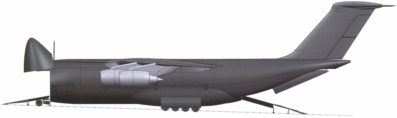

According to the project, the new aircraft is supposed to create a high-profile. Loading in the transport is supposed to be done through the nose. The aircraft will be able to transport cargo weighing up to 150 tons at a distance of up to 7 thousand kilometers. Cruising speed "Elephant" will be 850 kilometers per hour.
In the commercial version of the aircraft, created under the requirements of the carrier “Volga-Dnepr”, the carrying capacity will be 180 tons. The prospective aircraft will be four-engine; it will be equipped with new PD-35 turbofan engines with a take-off load of 343.2 kilonewtons.

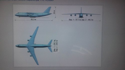

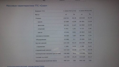

The length of the "Elephant" will be 82.3 meters, height - 24 meters, and wingspan - from 87.1 to 88.3 meters, depending on the version. The maximum take-off weight of the prospective transport worker will be from 490 to 499 tons, and the empty mass - 214 or 222 tons.
For comparison, the An-124 has a length of 69.1 meters, a height of 21 meters and a wingspan of 73.3 meters. The aircraft is equipped with four engines D-18T takeoff load of 229.9 kilonewtons. The transporter is designed to carry up to 120 tons. Its flight range is up to 7.5 thousand kilometers at a speed of 850 kilometers per hour.
Purge tests of the Elephant aerodynamic model will be conducted in subsonic and transonic pipes. These tests will determine the main flight characteristics of the prospective aircraft, as well as obtain the data necessary to correct the aerodynamic characteristics of the transport.
In October last year, a purge test model of a heavy transport screening vehicle was held at the Central Aerohydrodynamic Institute. Scientists investigated the aerodynamics of the model near the screen, simulating the earth's surface.
The EKR project assumes that the device will be able to carry out intercontinental flights with a range of at least six thousand kilometers. For the most part of the flight, the screening vehicle will be within the range of the screen effect at a height of three to 12 meters from the earth or water surface. Due to this, the device will spend less fuel.
