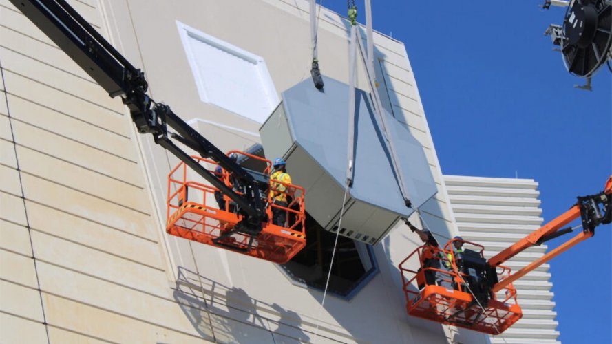

The U.S. Navy is putting the radar on all new destroyers, as well as aircraft carriers, amphibious ships and frigates – every class of ship. Some of the work is already underway at the Huntington Ingalls Industries, or HII, shipyard in Pascagoula, Mississippi, where Raytheon is integrating:
Work has started at other shipyards, where the company is integrating:
- SPY-6 (V)2 onto the future USS Richard M. McCool (LPD 29) and has completed the first sea trial.
- SPY-6 (V)1 onto the future USS Ted Stevens (DDG 128).
- SPY-6 (V)2 onto the future USS Bougainville (LHA 8).
- SPY-6 (V)3 onto the future USS John F. Kennedy (CVN 79) at HII in Newport News, Virginia.
- SPY-6 (V)3 onto the future USS Constellation (FFG 62) at Fincantieri Marinette Marine in Marinette, Wisconsin.

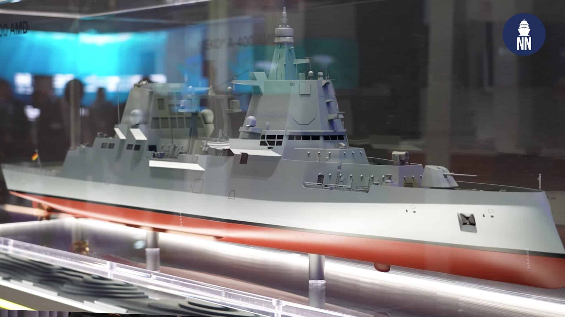

Right now TKMS Meko 400 Looks like the fastest solution.... building would start in Germany 2025
