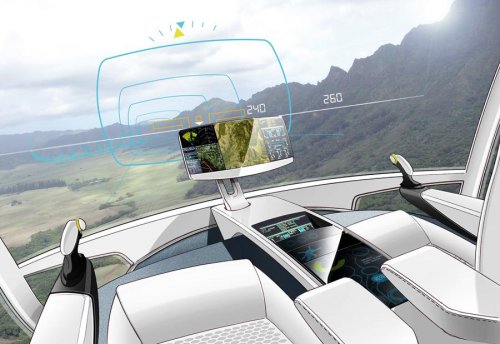

So is the X4 going to be controlled by a phone app or does it have a raised Wessex style cockpit? ;D
The main cockpit display in Eurocopter’s X-4 will be projected on the windshield, with the flight path shown in highway-in-the-sky style. A central display, in a more conventional head-down position, will present navigation and power information.
http://www.ainonline.com/?q=aviation-news/ainalerts/2011-10-13/sagem-touts-fly-wire-benefits-eurocopter-x4

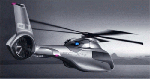

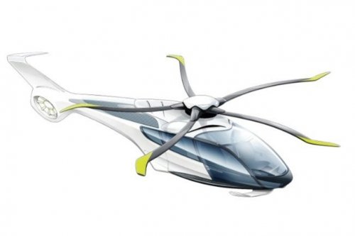

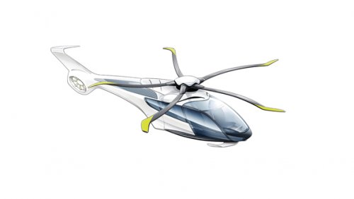

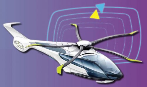

Artist's impression of Eurocopter X4 provided by Eurocopter published in Safran newsletter.
http://www.aviationtoday.com/rw/products/airframes/X4-Dauphin-Replacement-Planned-in-Two-Steps_73733.html

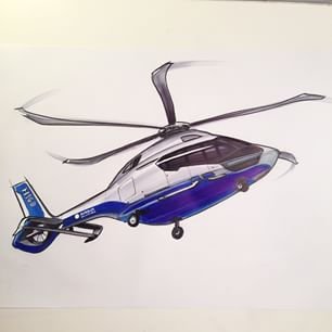

Eurocopter X4 Design Details Emerge
by THIERRY DUBOIS December 5, 2013, 3:43 PM
A new artist rendering of the in-development Eurocopter X4 medium-twin helicopter appeared today during a presentation made at the EASA Rotorcraft Symposium in Cologne, showing design changes made since 2011. A horizontal empennage with a two-level lifting surface is visible on the tailboom, forward of the shrouded tail rotor. The fuselage, aft of the cabin, includes a “skirt,” the role of which is still unknown.
Its main rotor retains five blades, which seem to be drawn from the Blue Edge research blades, have a double-swept design intended to reduce blade-vortex interaction and noise. The X4, a replacement for the AS365/EC155 Dauphin series, will compete in the 9,000- to 12,000-pound category and be released in two versions.
The first, less advanced, version of the helicopter will enter service in 2017. In 2020, the second iteration of the X4 will feature a cockpit with advanced human-machine interface and fly-by-wire controls. Customers will have the choice between two 1,100-shp engine options: the Turbomeca TM800 or the Pratt & Whitney Canada PW210. Messier-Bugatti-Dowty will supply electric brakes.

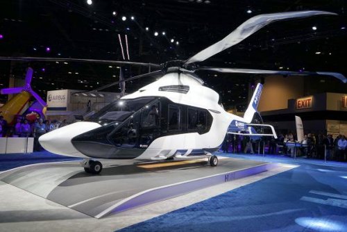

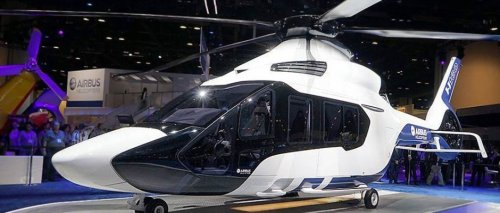

"Airbus Helicopters unveils H160 medium twin"
by Thierry Dubois
- March 3, 2015, 11:00 AM
http://www.ainonline.com/aviation-news/business-aviation/2015-03-03/airbus-helicopters-unveils-h160-medium-twin

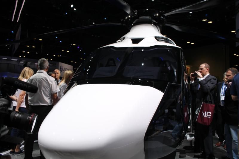

Airbus Helicopters unveiled this morning at Heli-Expo 2015 the H160 medium twin, a long-awaited successor for the Dauphin family and designed to lock horns with the AgustaWestland AW139 in the 12-passenger market. Codenamed X4 until now, the clean sheet design features Blue Edge main rotor blades for quieter operation, a canted Fenestron tail rotor for increased payload and the Airbus Helicopters-developed Helionix avionics suite installed on the EC145T2 and EC175. Other innovations include a full composite airframe, a biplane stabilizer–for improved main-rotor efficiency–and an electric landing gear. On display here (Booth 2437) is a full-size mockup. First flight is planned for this year and entry into service in 2018.
For the offshore oil-and-gas mission, the H160 will offer class 1 takeoff performance for 12 passengers and a 120-nm radius of action. In search-and-rescue, hover out of ground effect can be maintained at up to 5,000 feet and range reaches 450 nm with a 20-minute reserve. The smooth cruise speed will be 160 knots, without any counter-vibration system.
Aurélie Gensolen, Dauphin family and X4 marketing product manager, said this is equivalent to the AW139’s performance, “for one metric ton less.” Speaking during a pre-show briefing at company headquarters in Marignane, France, she would not give a precise mtow but said the H160 belongs to the 5.5- to 6-ton category (12,000 to 13,000 pounds). The AW139’s optional mtow is 6.8 tons (just under 15,000 lbs). “Operating costs are directly linked to the weight,” she emphasized. Airbus estimates the H160 will have a fuel burn advantage of 15 to 20 percent over the AW139.
The five Blue Edge blades, already seen on an EC155 demonstrator, will bring a three-decibel improvement over the noise level of a production EC155. The 12-degree canted tail rotor is the first such design with a shrouded Fenestron. It combines the normal anti-torque role and a vertical lift component, which increases payload by some 90 pounds, according to Bernard Fujarski, Airbus’s senior v-p for the X4 program.

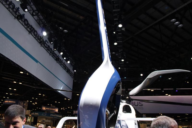

The third major aerodynamic feature is the biplane stabilizer. It retains its stabilizing function in forward flight and increases stability in approach, according to its designers. The biplane stab also reduces the masking effect such a surface has on main rotor thrust; the bottom line is another 110 pounds of payload improvement.
The electric landing gear is seen as lighter and safer than its hydraulic equivalent. For safety, the key is eliminating lines full of high-pressure hydraulic fluid below the cabin floor. Zodiac Aerospace is thus supplying the first-ever electric landing gear on a helicopter, AIN understands.
A deicing system is not planned yet, although provisions have been made. Demand is not expected at a compelling enough level anytime soon, as “most oil-and-gas operations with medium twins take place in the Gulf of Mexico and Asia,” Gensolen said. Fujarski added that the weight penalty would be “greater than one passenger.” The AW139 is available with an optional “full ice protection system.”

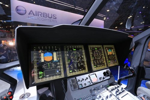

The Helionix flight deck is similar to that of the EC175, based on four six- by eight-inch displays. A major difference is the return of the overhead panel for engine controls. Cursor-control devices are a key pilot interface and for the mission display a touchscreen will be optional.
The avionics philosophy remains the same as in the EC175, as design engineers have strived to alleviate pilot workload. Another focus in the cockpit’s design is improved exterior visibility, test pilot Olivier Gensse explained. The H160 will be certified for single- and two-pilot operation.
Most composite materials for the airframe are similar to those found on the military NH90. Airbus expects a reduction in maintenance needs and “maximized occupant safety.” An innovation on the rotor hub is the use of thermoplastics for lower-cost manufacturing, reduced weight and, above all, damage tolerance–a crack will propagate very slowly. Airbus Helicopters designers believe the hub has the greatest thickness ever of a thermoplastic part in aerospace. Conventional rotor hubs are metallic, although other Airbus Helicopter models such as the AStar are equipped with composite hubs, which use glass fiber and thermoset resin. The H160’s hub is made from carbon fiber with a thermoplastic resin.

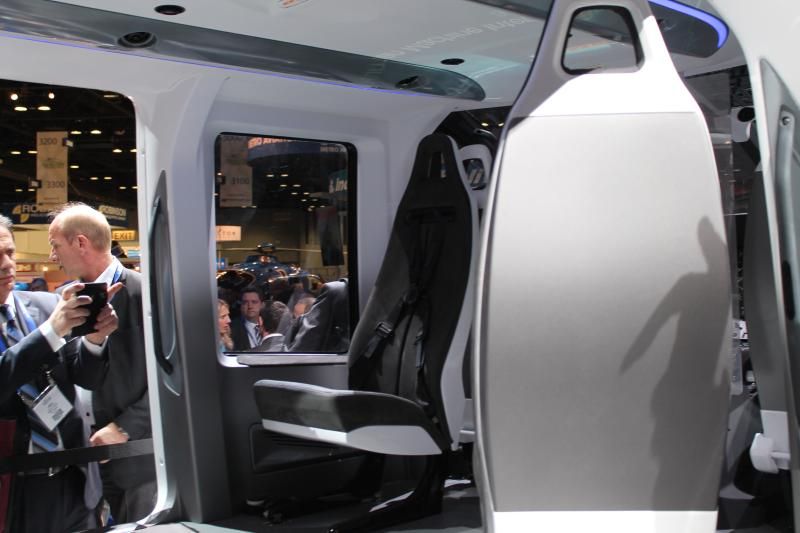

Another tool is the digital mockup. A notable use is to involve customers in the maintainability aspects. For example, retractable footsteps have been integrated in the side fuselage for easier access to the engines. A virtual mechanic could “test” them, thus pre-validating the design.

X4 Design Evolved Since 2011 Concept
In its definitive form, the X4 is relatively far from the early design unveiled in June 2011. At the time, envisioned was a radically new man-machine interface, including touchscreens, other advanced displays and fly-by-wire (FBW) controls. Former CEO Lutz Bertling often emphasized that the pilot would benefit from enhanced assistance. In a famous quote, he started saying in 2011 that someone taking one of the front seats would miss something–the cockpit.

Artist's impressions of the Airbus Helicopters H160, not photographs.
http://aviationweek.com/commercial-aviation/airbus-removes-veil-h160-project
http://www.shephardmedia.com/news/rotorhub/heli-expo-2015-introducing-h160/
http://www.pilootenvliegtuig.nl/2015/03/03/scoop-airbus-helicopters-introduceert-h160/

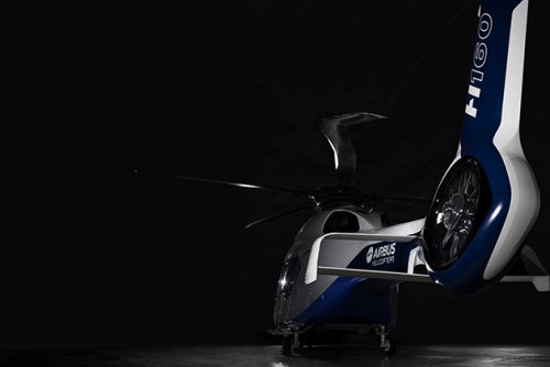

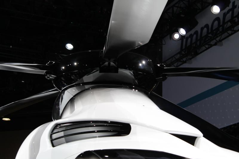

VTOLicious said:
...what a beauty!
Well another sexy French helicopter. Very nice lines. Impressive claims for performance as well.

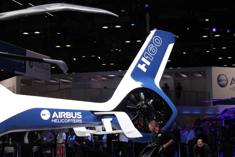

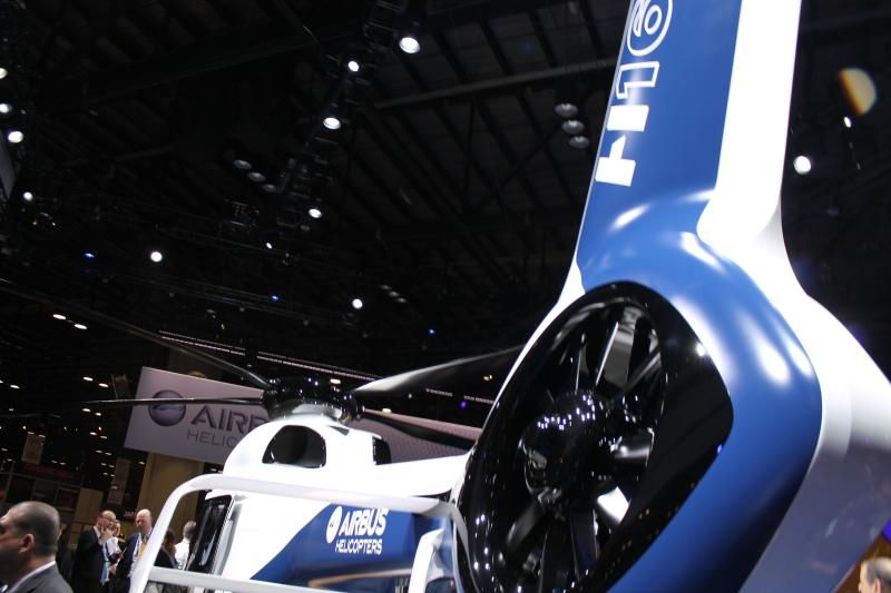

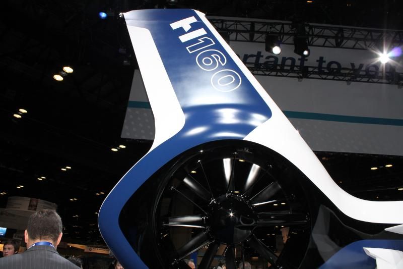

I am at Heli Expo and was in the front during the unveiling, here are my pics from this morning,
enjoy and cheers
http://www.intelligent-aerospace.com/articles/2015/03/airbus-helicopters-unveils-all-new-h160-medium-class-rotorcraft-formerly-called-x4.html
The H160 integrates Airbus Helicopters’ Helionix avionics, designed to deliver increased safety through reduced pilot workload, enhanced situational awareness, improved flight envelope protection, and system redundancy. In service today on the EC175 and EC145 T2, Helionix is an avionics family concept that enables software improvements to be integrated and retrofitted on the H160 as well as other helicopters in the company’s current, future, and evolved product lines, officials say.

Some nice photographs of the full-scale mock-up of the Airbus Helicopters H160 on display at HAI Heli-Expo 2015.
http://www.heliweb.com/wp/2015/03/04/the-future-is-now-airbus-helicopters-unveils-its-all-new-h160-as-the-benchmark-for-medium-class-rotorcraft/
https://pbs.twimg.com/media/B_Q_cvcUQAAy7ej.jpg:large
http://aerossurance.com/wp-content/uploads/2015/03/IMAG10091-1024x579.jpg
A nice aircraft, without doubt. I just can't help the feeling, that the one, who wrote that
article on heliweb.com, more often writes for the company with the bitten apple, or for
companies selling handbags and backpacks made from Kevlar or carbon fibre as the
most fashionable accessoires. That Airbus "made history" still has to be proven, or maybe
in a sense every new aircraft makes history.
Well, publicity department vs. construction department, 2 : 1 at half-time . ::)
