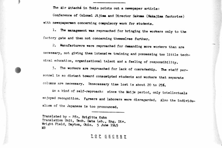

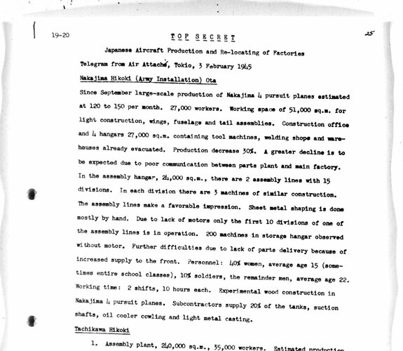

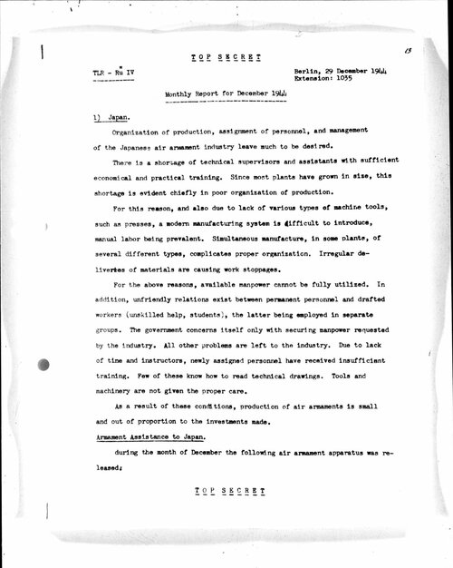

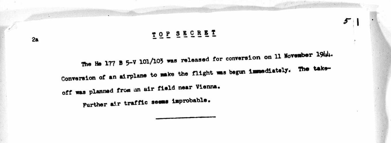

One document (No. 4009762) translates a German report on the Japanese war efforts, dating from November 1944.
"It is extraordinary that, considering the amount of the workers and factories, aircraft production is noticably smaller than in Germany."
The reasons are given as (with a bit of my interpretation):
- Insufficient numbers of qualified workers and, especially, managers, and insufficient training for the average worker
- Insufficient production of flight instruments (which I guess means aircraft ("Fluggerät") ... the translation seems a bit odd here) - not designed for mass production, lacking standardization, ignorance of manufacturing methods, including tooling.
- Poorly organized factories - for lack of technical personnel, incomplete understanding of adapted foreign technologies, a pre-industrial mindset, lack of standardization, tooling poorly suited for mass production. Outsourcing of production tasks is poorly organized, too.
- Machine tools - due to the priority of aircraft production, standard machine tools are available in sufficient quanitities, but special tools such as presses are scarce, which impedes mass production. The available special tools were imported before the war from the US, Britian and Germany, but Japan basically has no production capacity to speak of for such machines.
- Raw materials: Steel is in danger of running short, but the aviation industry received priority for the moment. Ore and bauxite is available in sufficient quantities, but the enemy advance in the south threatens this availability.
- Transportation: Currently there is just enough transportation capacity to provide raw materials, but once the Allies start attacking transportation, that might easily cause a crisis.
Summary:
"[...] the ignorance of the constructors [= designers] regarding production methods together with lack of standardization, good technical personnel, and a number of special machine tools and the resulting old-fashioned manual production prevents greater output of flight instruments [= aircraft, in my opinion]"
Some interesting quotes are included in the attached snippets.
Yes, I'd agree with your interpretation of the word "Fluggerät".
