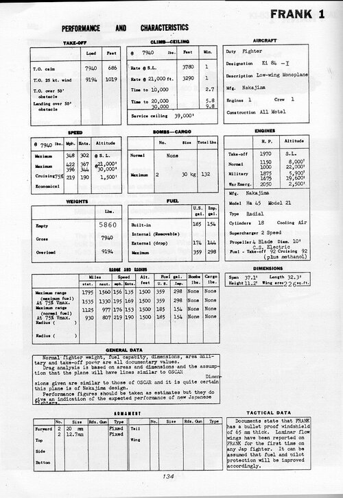

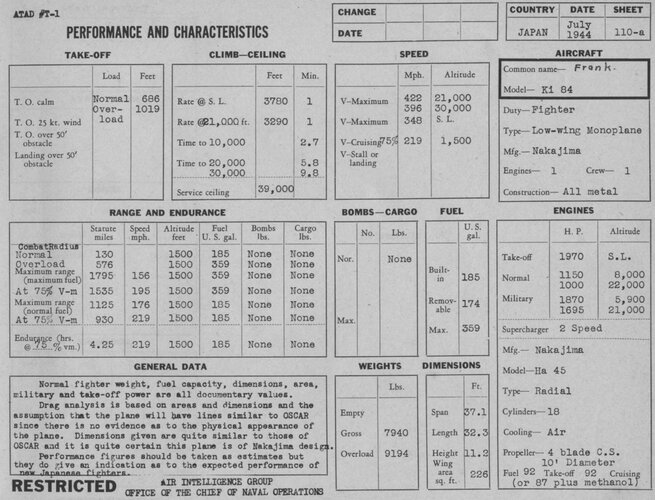

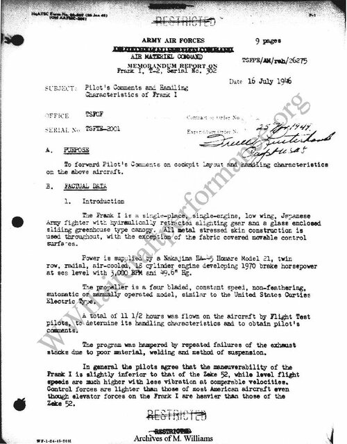

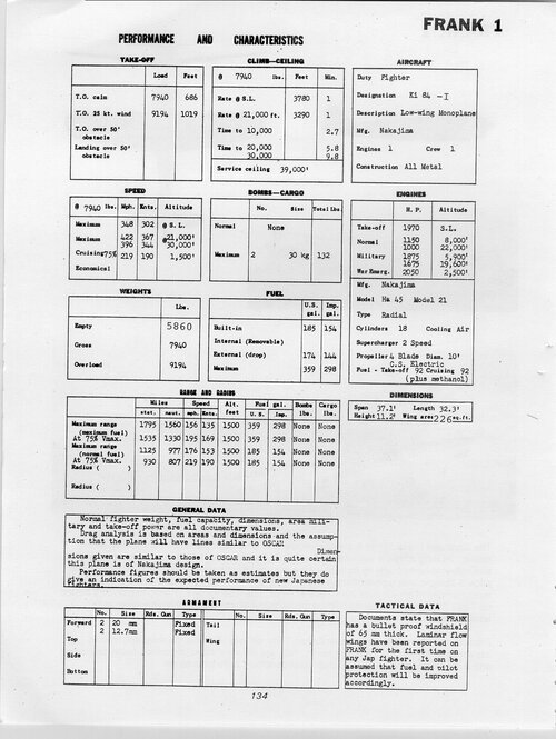

One of reasons the Ki-84 was regarded competitive vs. P-51 and P-47 was the speed of the Japanese fighter. Americans clocked more than 420 mph on the Ki-84.
I don't think 422 mph @ 21,000 ft was a speed actually achieved in any US test as it comes up right in the first performance analysis distributed in the TAIC intellegence data sheets, where it's clearly indicated as being based on a drag analysis of the Ki-43 (obviously combined with the power curve of the more powerful engine the Ki-84 was known to use).
These data sheets went through a couple of revisions - see attachments -, but I believe the only change was a small adjustment of critical altitudes at some point.
The Ki-84 was indeed flown in the US, but it seems that only general handling and characteristics were covered. The respective report (which can be found on wwiiaircraftperformance.org) points out that even the general handling tests were hampered by repeated failures of the (poor quality) exhaust stacks, and testing for performance would probably put a lot more stress on these.
So, considering that the aircraft was not in a good condition for performance testing, and the fact that we have documents on general testing and engine overhaul, but not on performance testing, while the test figures allegedly achieved in US testing are exactly the same as the numbers calculated from the very early intelligence estimate derived without knowledge of what the Ki-84 actually looks like, my conclusion is that they can't be considered to be reliable.
There is a number of Japanese tests as well, but they were from the developmental phase in which the type that might not have reached the full potential of airframe and engine yet, but my overall impression is that realistically, the Ki-84 probably wasn't able to reach the performance numbers from the TAIC estimates.
* German pilot was doing that with Bf 109E-7 in Japan, angering the Japanese to no end. At the end, that experience saved the Ki-44 project, the only Japanese Army fighter that was able to emulate the 'boom and zoom' tactics the 109 was well suited for.
