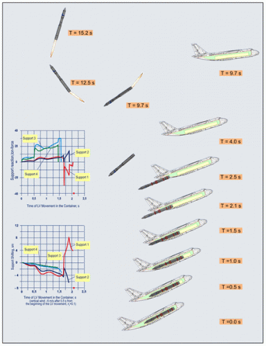

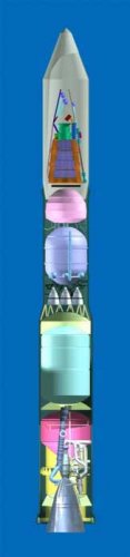

Airlaunch Aerospace Corporation http://www.airlaunch.ru/
interesting that this system drops the vehicle nose-first , and without a parachute...
