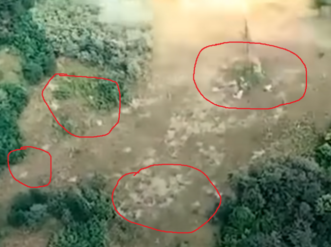

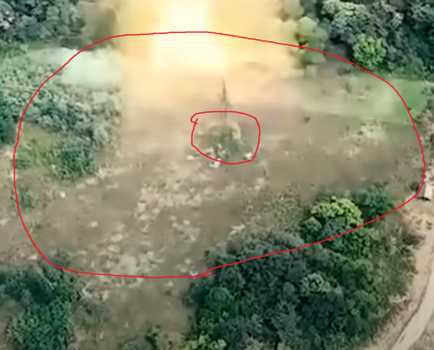

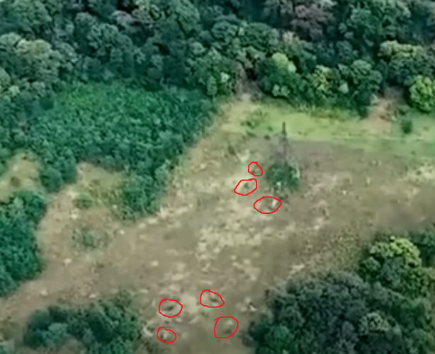

Watch on full screen around the mast(?) in the foreground just before the large explosion.
Did finally see them, but I'm still thinking those were something like SADARM skeets. There were only like 8 pops, which isn't consistent with the submunition count of DPICM (some 65 individual subs per shell). So unless the subs mostly landed in the trees, I'm still not sold on it being DPICM. Feels more like a CBU-97 or -105 SFW strike.
SADARM is guided and there is only 2 to a round but it is a strange pattern for DPICM but there is more than one variant of DPICM I think. There's a lot more than 7, I'll try highlight all the strike areas to watch for.
I think there may be some landing in the trees too. Maybe these are the inner and outer circles with the trees hiding most of the strikes.
