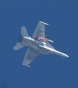

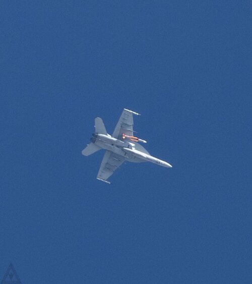

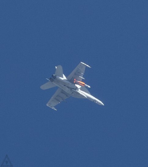

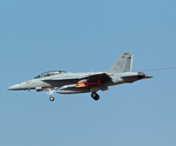

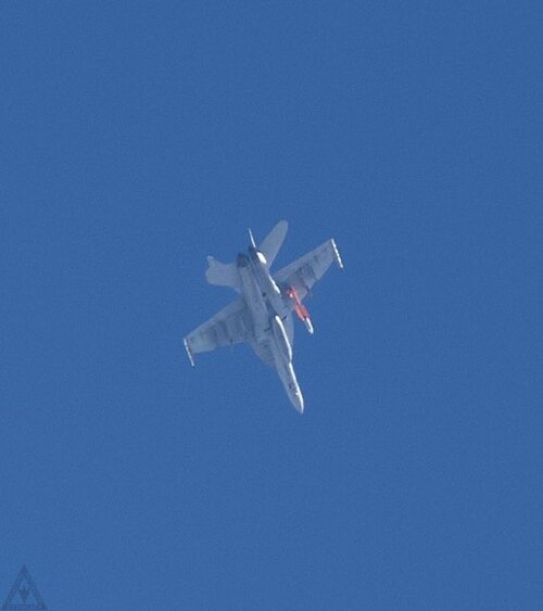

F/A-18 spotted carrying a SM-6 for the 2nd time earlier today.
View: https://x.com/StinkJet/status/1797728633639108651
Posted by this user, just uploaded so if their tweet is deleted we still have these :)
First spotting was back in April: (already posted here but linked again for convenience)
