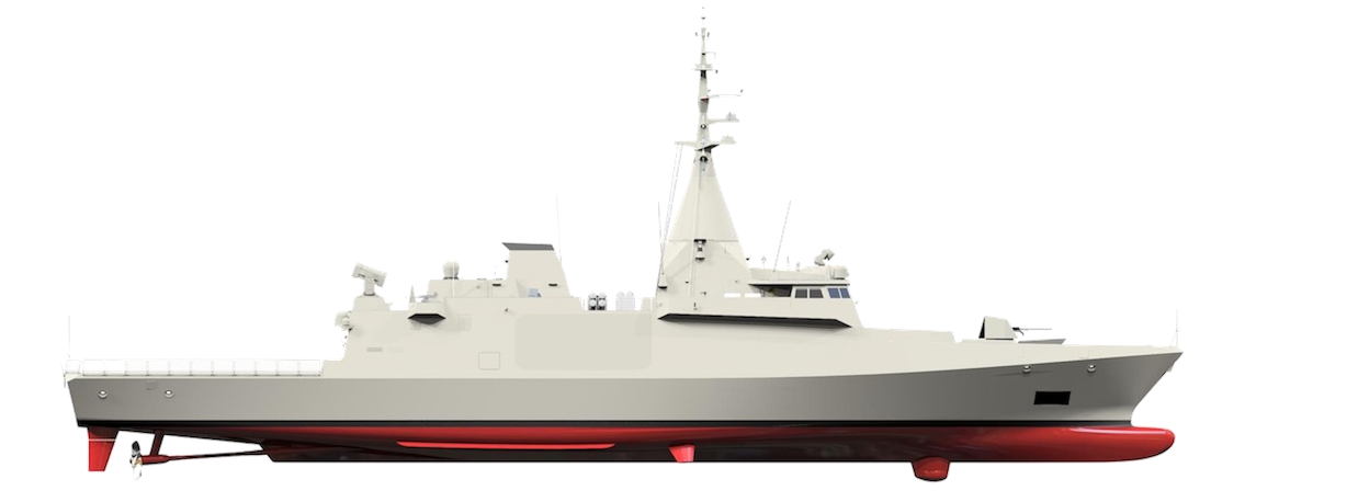

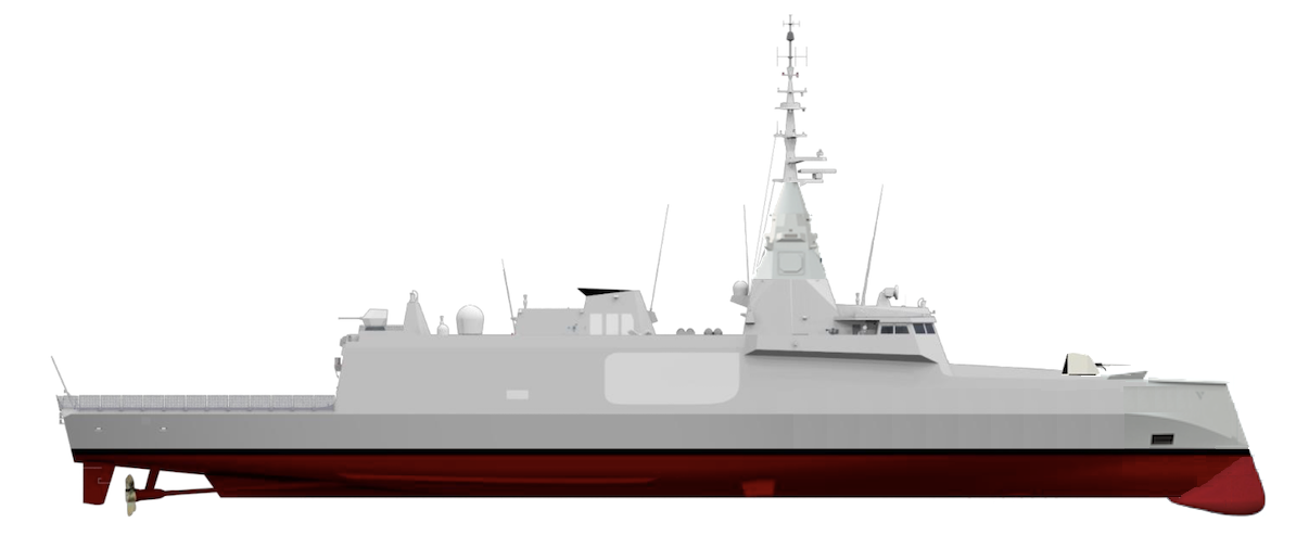

Nothing new here that hasn’t already been done by others. E.g. Gowind class corvette / light frigate.
Not sure how much this will cost, but this is the sort of frigate I think the USN needs.
A 3000ton ASW-only craft?
Too small. Even the FFG-7 class was noted for limited endurance, which means a larger ship for more fuel, food stores, and crew habitability space.
Plus, any convoy escort these days needs to be able to provide at least minimal area defenses, and the Tuo Chiang class only has 16x ESSM equivalents and no SM-2s.
Gowind does it rather better. Of course given the situation Taiwan is in, I'd suggest they build minelayers and SSKs, light frigates are too limited in capability to be viable, and Taiwan can't really afford anything better. Should probably just use SSKs and minelayers, with the hope that the latter can do their job in the last days of peacetime before the balloon goes up.
