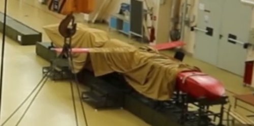

Sorry, i think the thing just doesn't look pointy enough for m.2.9...
You may well be right. Although it does pose a valid question. Why didn't they go supersonic?
Probably because the reactor does not produce enough power to go supersonic...

I know but hey, we're working on assumptions all the way here. In many ways it makes no sense to have a nuclear turbofan instead of a ramjet. It's slower, it weighs more, it's larger and there are no relevant range benefits.
So this is supersonic, Mach 2.9 vehicle. OK
Note that nothing says how LONG it could "do" that speed :)
Given the nose and wings, (they don't sweep) I think the "2.9" was supposed to be "0.9something" but it got hyped.
On the other hand you could probably push the airframe to such speeds on a 'terminal run-in' to targe for a very short period of time.
Reverse the question, why would they go supersonic? Subsonic is 'more stealthy than supersonic and structurally easier to build to. RAM materials that can handle sustained supersonic speed are harder to handle and maintain than subsonic materials. (Though from the picture that looks AWFULLY blocky to be very stealthy) And keep in mind this has to be 'supersonic' at very low level over very 'cluttered' terrain for the most part and that would require active sensors which also is detectable.
Most modern cruise missiles fly a subsonic, terrain-following flightpath using passive sensors to make them difficult to intercept. Supersonic flight it good for eating up long distances or as a dash-speed for avoiding point-defense systems. The idea here would appear to be to use the nuclear propulsion system as a means to expand the possible attack vectors to make any defensive preperations less effective. I'm not so sure that, taken as a whole concept, this would actually turn out to be as effective as suggested. However...
