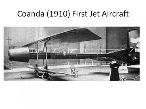

"Just seven years after the first flight by the Wright Brothers,Henri Coanda flew the first jet powered aircraft."
What Alternate History would have been experienced if they continued to pursue development of the Coanda Jet Engine back in 1910?
See e.g. "Indiana Jones and the Sky Pirates" by Martin Caidin.

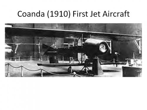

Found this statement at http://www.militaryfactory.com/aircraft/detail.asp?aircraft_id=682
"In terms of its "jet" powerplant, the Coanda 1910 featured a system unlike that as found in later turbojet developments. The Coanda operated with a type of "thermojet" technology in mind - in general terms it was a combination of piston engine and jet engine power - relying on internal combustion and not a gas-powered turbine common to turbojets. The traditional combustion engine provided power to a compressor to generate compressed air. The compressed air was then mixed with fuel, ignited and forcibly extracted from special chambers mounted on either side of the fuselage. The resulting force of the expelled reaction was to provide forward momentum for the aircraft.
The Coanda 1910 achieved a single short flight in an accidental sort of way. While ground testing the engine with Henri Coanda at the controls, the powerplant forced the plane airborne for a short time. As Henri himself was not a pilot by trade, he quickly lost control of the aircraft and crashed to the ground throwing him clear of the burning wreckage (though not without slight injuries). Despite the loss of the machine, Henri noted an effect occurring with the expelled gases and how they seemed to conform to the sides of his aircraft. This observation alone would lead Henri to research that would span decades more in what would eventually culminate in the "Coanda Effect" being named in his honor."

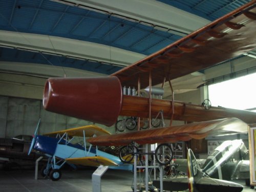

One photo of the aircraft replica of the reply 8' video.
This replica is presented by the Muzeul Miltar National, Bucharest.
Looking at the replica and the famous 1910 photo something always puzzled me: with the jet forward and the pilot behind... well, poor pilot would have been burned alive.
Now I have the answer to tmy qyestion.
It was not a jet, so less risk for the pilot ;). Well, no risk at all in fact, with the plane not flying at all ;D

Re, the replica, how accurate is it? Is it just a shell or does it have an accurate engine? If so where did they get the drawings/information for it? Is there anyone on the forum who lives close enough to reasonably go and have a look?

Another news :next year for the century aniversary of the first jet flight, a 1:1 replica of the
Coanda 1910 is made with the intention to be flown !

Have the people who are proposing the replica posted any information online? Surely with less than a year they must be well advanced in their project!
