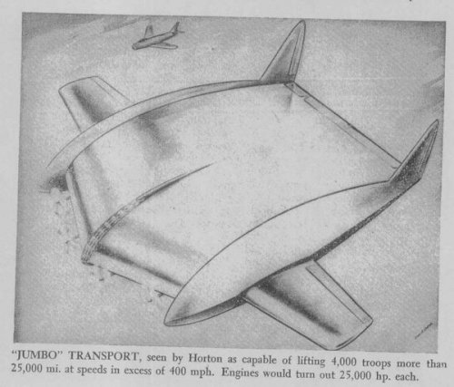

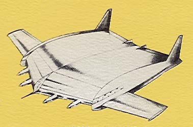

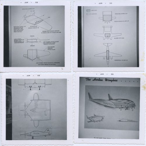

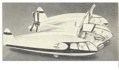

additional pics

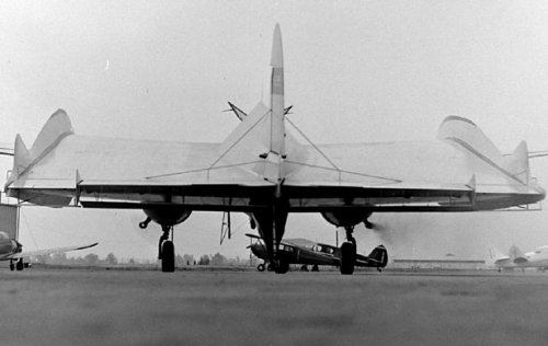

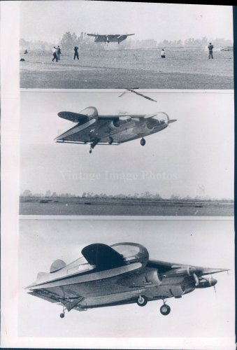

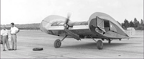

Too long powershafts vibrations

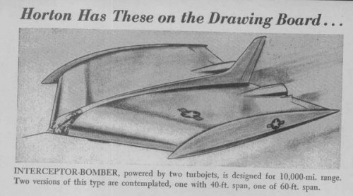

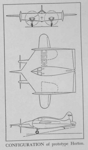

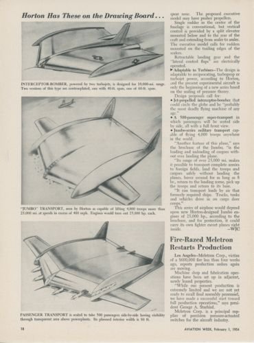

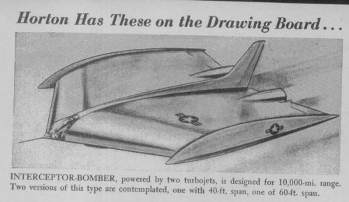

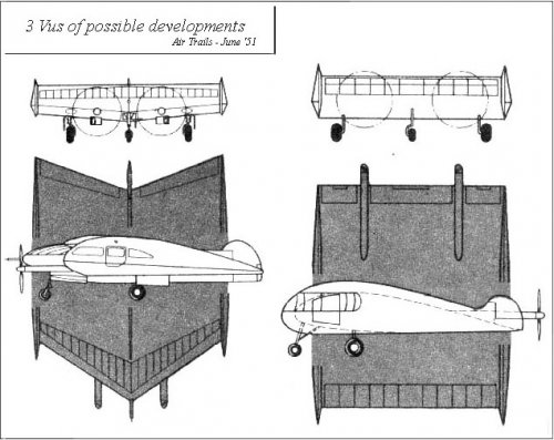

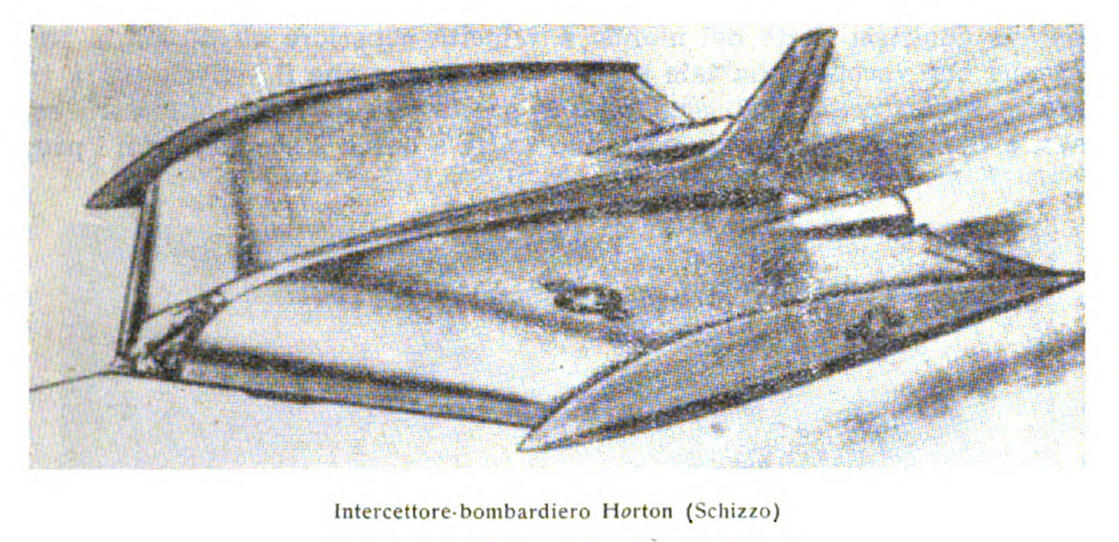

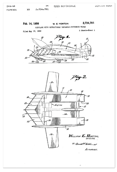

At least a proof-of-concept demonstrator flew in 1954.
3-view is from Aviation Week .2.54, where other designs
were shown, too, one of them captioned as "Interceptor-bomber".
It takes a long time, before all mistakes are made ...

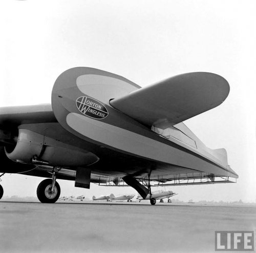

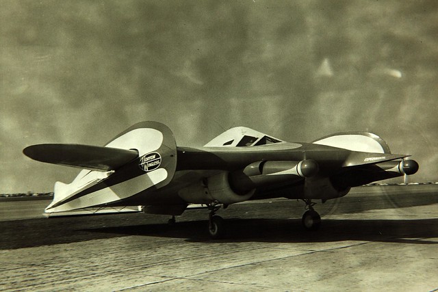

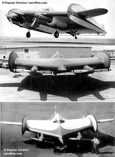

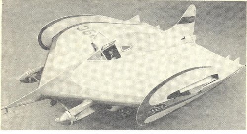

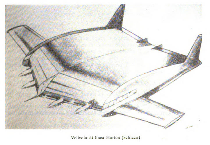

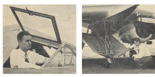

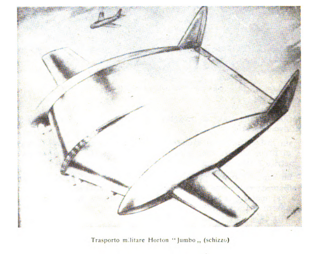

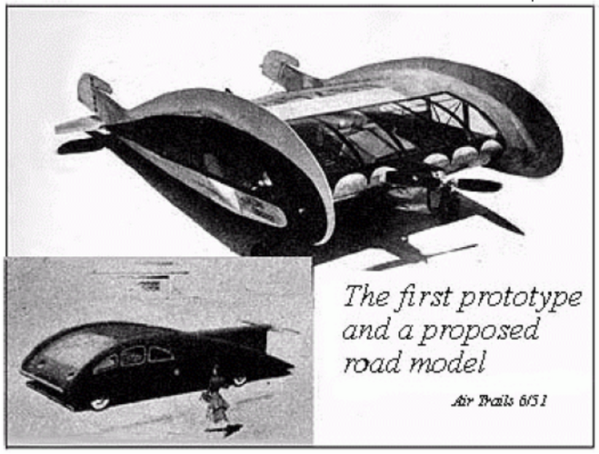

The core of the aircraft in Justo's photos No. 1 thru 3 and the right hand photo in No. 5 is that of a Cessna T-50/UC-78 Bobcat - you can make out the Jacobs radials and associated cowlings in a couple of the photos.  Pretty drastic change in contours :-)

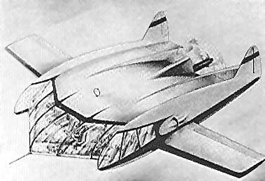

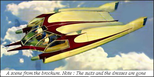

Has anyone heard of William Horton? He apparently did only one real aircraft, the "Swoopy" (see attachment). However, he also designed this car/aircraft crossover vehicle, seen in the flying cars thread:
This Horton has nothing to do with HortEn (a German) but many people misspell the latter like the former, which renders any search pretty difficult!

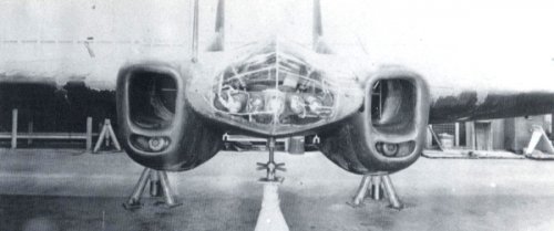

Funnily, the cockpit design and general shape of the fuselage echo those of the Northrop XP-79B "Flying Ram" fighter prototype, also attached. Any connections here, or only a coincidence?

"Has anyone heard of William Horton?"
At least the team, which published the Aviation Week February 1954 had
heard of him.   ;)
His designs were described as wingless aircraft. Ok, I would rather call them
flying wings, but that's maybe a matter of taste .

I don't doubt your sources, but the 'Swoopy' looks remarkably similar to the Northrop 'Rammer' aka 'They Shall Not Pass even when the ammo runs out'...

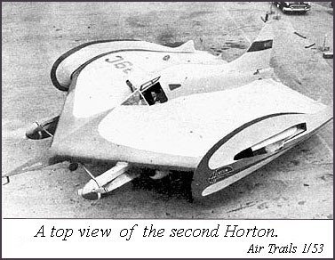

Mystery solved! The first part of the Air Trails page shown at the top is here, and proves there were actually two distinct prototypes:
The only archive of the "skunk works digest" refer to a post by Tom G. which said the following:
Quote

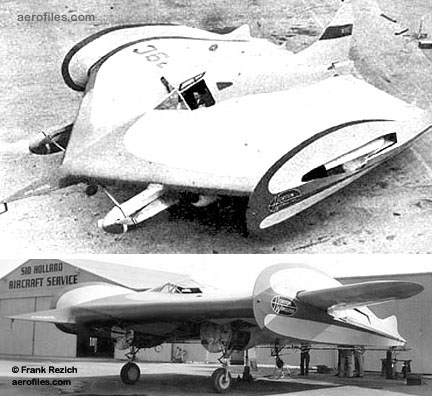

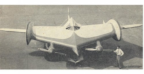

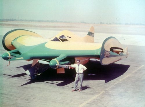

"there was a single modified Cessna UC-78, registered "N39C", and named "Horton Wingless", (Model "HW-X-26-52") c/n "HW-X26-52", by its designer William E. Horton of Santa Ana, California (or Henderson, Nevada ?) The aircraft was equipped with a strange blended-wing fuselage with large wing fences, and was powered by two 225 hp Jacobs (or Wright R-985 ?) piston engines. It flew for the first time in 1951/52, but was destroyed (burned) after no financial backers for its series production could be found, even though it is still registered in the FAA database (FAA type is 056-01-NU)."

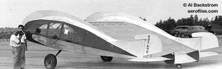

The Aerofiles website confirms as follows:
Quote
William E Horton, Santa Ana CA. Wingless 1951 = 2pC flying wing; two 225hp Jacobs and extended driveshafts; span: 40'0". Not truly wingless, but essentially a highly-modified Cessna UC-78 with a more airfoil-shaped fuselage than wing. POP: 1 [N39C]. Although this innovative protoype flew successfully, no backers were attracted, and the project was abandoned, with the plane eventually being deliberately burned.
However, both the initial document I posted and the photos from Aerofiles point to the existence of two separate prototypes, registered as N87698 and N39C.

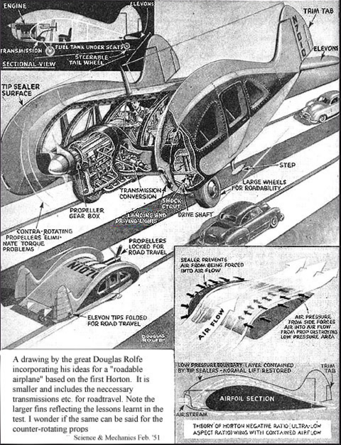

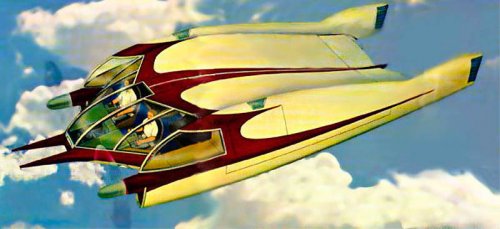

A member of the RC Groups Forum offers a very interesting illustration by Douglas Rolfe and confirms the existence of two prototypes:
Quote
I have not seen any pictures of N87698 in the air....this is the one that the roadable version in the drawing was based on.
The one that actually flew the most was N39C, which had some retractable main wing panels.
A very interesting webpage from the site Twin Pushers and Other Free Flight Oddities devoted to Horton shows lots of pictures and explains that the first prototype had an accident:
http://home.att.net/~dannysoar/Horton2.htm
The FAA base indeed has kept the #2 prototype in its records, so it's safe to assume that the one that got destroyed was #1... although there is no evidence that #2 still exists.
The same site presents other pictures of the second prototypes and documents the history of the project as well as gives pictures and details about the planned Horton V-12:
Finally, a scale modeler from the RC Groups forum did a nice flying replica of the very first Horton prototype (his webpage is here):
« Last Edit: January 09, 2010, 06:58:55 am by Stargazer2006 »

Found an amazing video of the second Horton prototype in flight!!! (third part of video)
