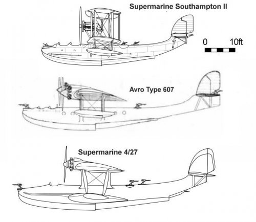

There are very obvious Supermarine stylistic features but it was to be significantly larger than the Southampton II
As I said, just a wild guess . . . It was only later I realised that three Jupiters is way too much power for a Southampton . . .
cheers,
Robin.

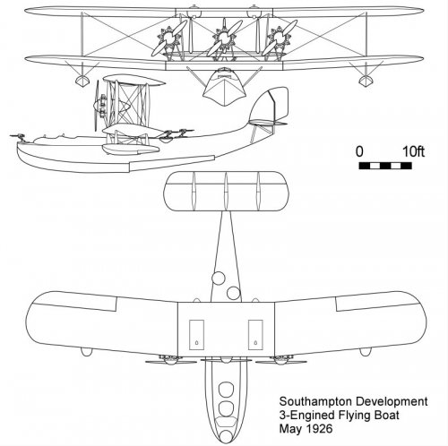

Not at all, it was a reasonable suggestion. Mitchell was thinking along the same lines :)

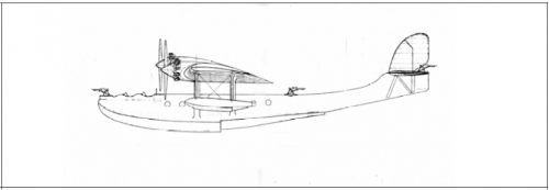

I think the Avro Heritage was wrong as my dear Schneiderman explained,and those
two Projects were submitted to Spec. 14/26 for commercial seaplane.
