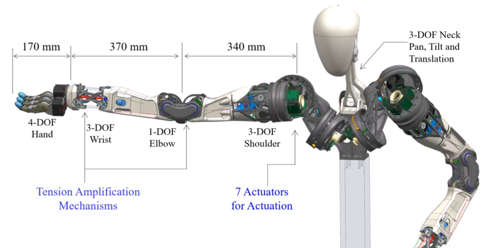

Via Danger Room:
View: http://www.youtube.com/watch?v=1JJzmfkufPE&feature=player_embedded
EDIT: Via Crunchgear, see below for a diagram of the bot:
