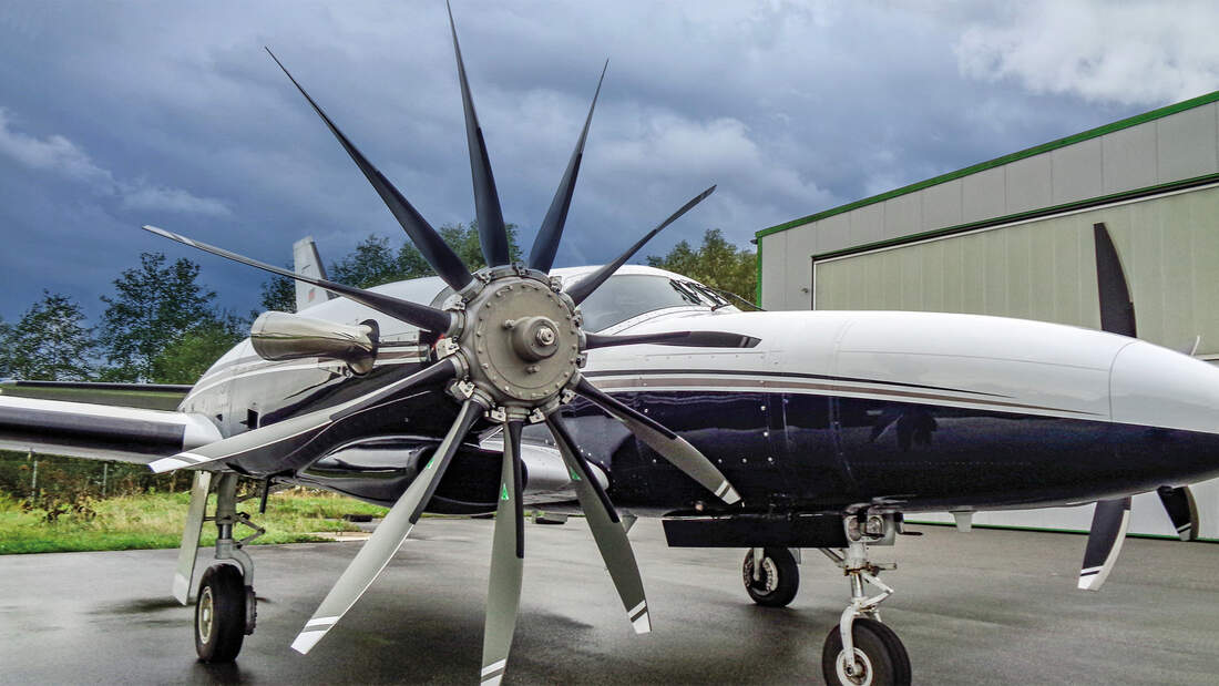

Are 11 thin blades better than 5 or 6 wider ones?
Like wing aspect ratio I figure longer thinner blades would technically be more efficient at producing “lift” but there may be speed efficiency curve issues that may limit altitude performance and max speed? Turbofan blades have moved to being wider and fewer, and even being mildly supersonic at take-off thrust but the duct and lack of pitch control creates a different working dynamic and set of requirements.
Generally no
Fewer high aspect ratio blades on as large a propellor diameter as possible should be most efficient.
But if you are limited by diameter and need to put more power through the disk then you need to increase blade area, from either more blades or wider chord blades

There's a bunch of tradeoffs (I did prop aero for several years), but generally if you spread needed blade area over more blades efficiency increases as induced losses are less. However, structural considerations will put a minimum limit on individual blade chord, hence area. Crowding between blade roots may cause shocks at high speed, reducing prop efficiency.
Noise is likely an issue, as noise increases rapidly with tip speed, but reducing tip speed means that more blade area is needed, and spreading that area over more blades tends to be advantageous.

So more blades, so lower the induced losses on the wingtips (as long as the other parameters haven’t changed). I guess, the reasons not to use 11 but 3 or 4 blades were mainly for mechanical reasons. The very thin and flimsy looking blades of this prop might have been impossible with traditional aluminum blades. The high damping material mix of the MT Props could be the enabler in this regard.
This design didn’t come out of nothing, MT was promoting the 5 blade props (to replace three blade props), then they tested a 7 and a nine-blade prop successfully and we might even see a 13-blade prop, who knows…

This looks more like a PR stunt than anything else to me. Its hard to see how 11 blades would be worth it, even if the prop diameter is really constrained.
MT is a company which knows what they are doing. The video sound might not be 100 % accurate, but the plane is totally missing the familliar propeller sound. It is very reasonable to believe, that they really archieved a very great noise reduction.
MT also mentioned 15 % higher trust at zero speed, this is nice to have, but the efficiency at cruise speed would be of intrest...
A good chunk of a propeller's blades are stalled during takeoff. This prop may have more unstalled regions than their baseline or it has too much area for optimal cruise performance
I think, the noise reduction is the driving force behind it. Many users (e.g. in Switzerland) will surly accept even a slightly lower cruise effeciency if they can use more airfields in exchange.

There's alot of complexity in having that many pitchable blades in such a small package but we have many newer technologies to produce more complexity for a given cost. This could be a real game changer for STOL planes really needing that 15% extra thrust as Nicknick mentioned in post #14, but such civil platforms are cost constrained from the get-go by operators. Producing 9 and 11 blade props needs to be affordable for the market that needs it most. Otherwise this really could just be a PR exercise or a showcase for potential military ops.
Don't forget that power on wing is increasing due to market demand while the overall volume available for a prop is generally constant. Also, new props will spend a higher time at increased speed (faster cruise speed) and higher power ratio (better climb performances).
Blades have then to be made stronger and still transform more power into momentum.
A good way to do this is to reduce the blade span and reduce the blade lift (higher nbr per rotor of equal diameter).
Availability of better Sciences at lower cost (CFD tools and newly formed engineers with overall knowledge of how to use them) make it a very efficient road to keep up with market requirements. The bonus is the retrofit market that makes those new rotors immediately cost efficient by spreading tooling and r&d costs.

I wonder if noise and vibration is the real driver here.
I'd say most likely yes, given this from the attached article,
MT-Propellers' five-bladed propellers have lower noise and vibration levels and have quickly become the industry standard. They are used on a wide range of aircraft, such as the Cessna 425 Series, Piper Cheyenne PA31T and T1, Piper Cheyenne PA42-1000, and Cessna 208 Caravan aircraft.
This is all about noise reduction, though a 15% boost in takeoff thrust is a very nice bonus.
