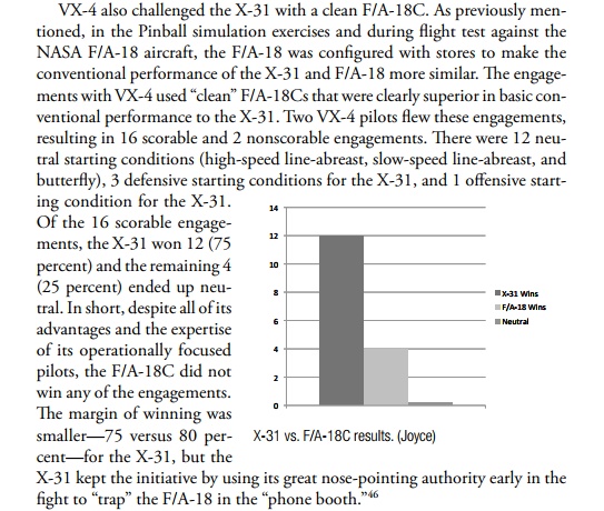

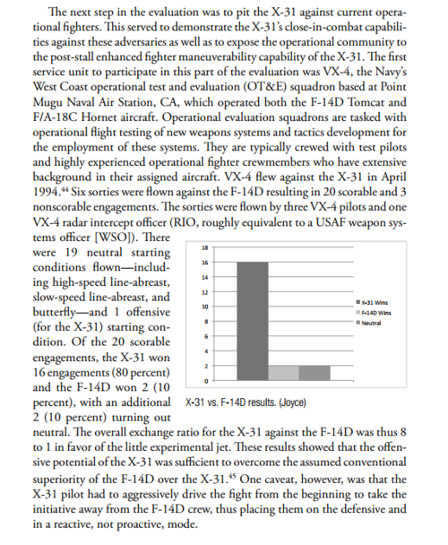

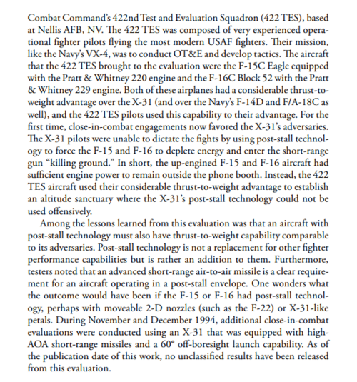

On topic of dogfight: NASA did some test between the X-31 with post stall technology against operational fighter at that time, and they find that while F-14 and F-18 get totally demolished in close combat, F-15 and F-16 actually achieve positive kill ratio due to their acceleration

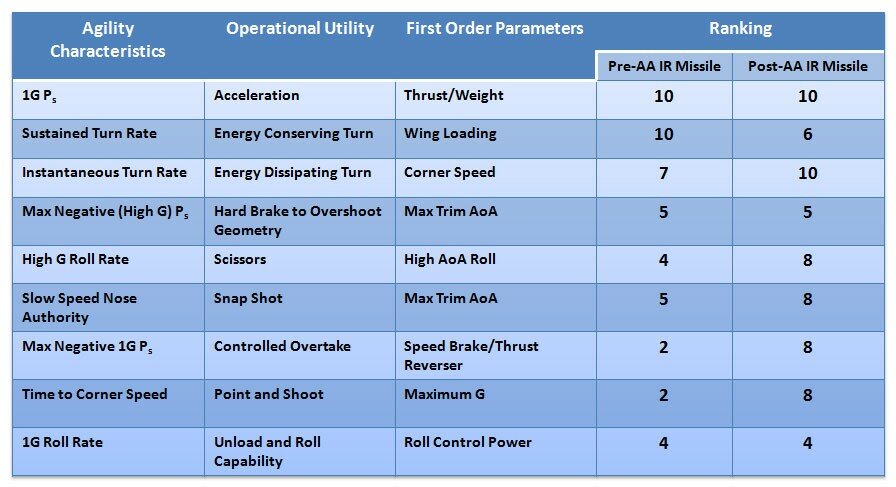

I think it's more complicated overall, though you can make some general statements like "As WVR missiles become more capable and all aspect, the important thing becomes how fast you can get the nose of the aircraft pointed in the right direction to fire the missile, and, with off boresight missiles becoming more prevalent, even that is becoming less important."
This is a summary chart from a blog post from Elements of Power; the whole article is worth a look and is here. AA refers to "All Aspect", i.e., it can be fired at a plane from any angle, not just from behind.

If he thinks the operational utility of sustained turn rate is an energy conserving turn, and that that was less important after the introduction of all-aspect missiles, there's a generation of air combat operational research guys and fighter designers would like a word.
All aspect SRAAMs increase the importance of not entering the merge, and high speed sustained turn rate is what lets you do that. (Not losing energy in the turn is important, but it's not why turn rate is important).
Given that the chart is talking about tactics/characteristics before and after all aspect SRAAMs, I assume the chart is relative importance of characteristics for WVR, which I also assume you would refer to as "during/after the merge"
If what you mean by "avoiding the merge" is firing missiles BVR and then avoiding WVR entirely, then there's more than one way to do that. Yes a sustained turn is one way to try and avoid a merge, but stealth or other methods work as well.
  • It's hard to argue that the F-35, for instance, isn't trying to avoid a merge via stealth much more than sustained turn rate. IIRC an F-16 will handily turn inside an F-35. Turning a stealth aircraft also brings up signature issues for planes with "bow tie" stealth vs. "all around" stealth.
  • The Split S is an example of a 180 change of direction without any sustained turn
  • Any significant advantage in radar and missile range for BVR gives more time/space for avoiding the merge
that chart still can't answer the question of what more important in WVR combat: the acceleration or the turn rate.
Some fighters are more focus on acceleration: English Electric lightning, F-16, F-15, Mig-29
some fighters are more focus on turn rate: F-18, Su-27, F-14
I believe what the chart is saying is that acceleration and turning are both very important, equally so, but what kind of turn rate is important changed:
  • before all aspect missiles, acceleration and sustained turn rate were both very important, which is consistent with historical dogfighting results
  • after all aspect missiles, acceleration remained very important but sustained turn rate became much less important. While sustained turn became much less important, instantaneous turn rate / corner speed became much more important, equally important to acceleration.
I'm not saying that the chart is definitive, no chart could be given the variables in air to air combat, but the history of WVR seems supportive.
