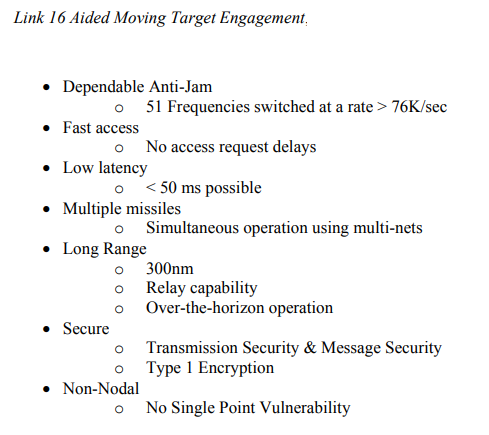

Ah, I figured it out. Aircraft can use link-16 datalink with range about 300 nm to control air to ground weapons such as JSOW, SDB II, JSM ..etc

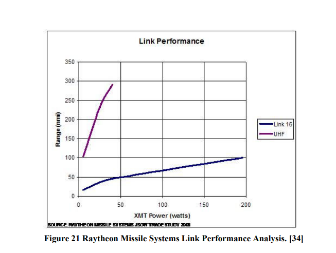

For the talk back range, link16 on weapons seem to be limited to around 50-100 nm
