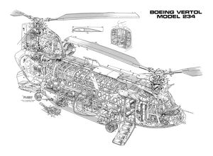

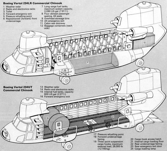

one idea of mine is modifying a Boeing Vertol 234. it has the power for a large water/retardant load and the manuevering capabilities for tight spaces/low altitudes and valleys/hills etc.

...one idea of mine is modifying a Boeing Vertol 234...
There are a bunch of Chinook air tanker conversions out there already - the Coulson-Unical CU-47 comes to mind. (Or were you talking about just using 234 dynamics with a purpose-built fuselage?)

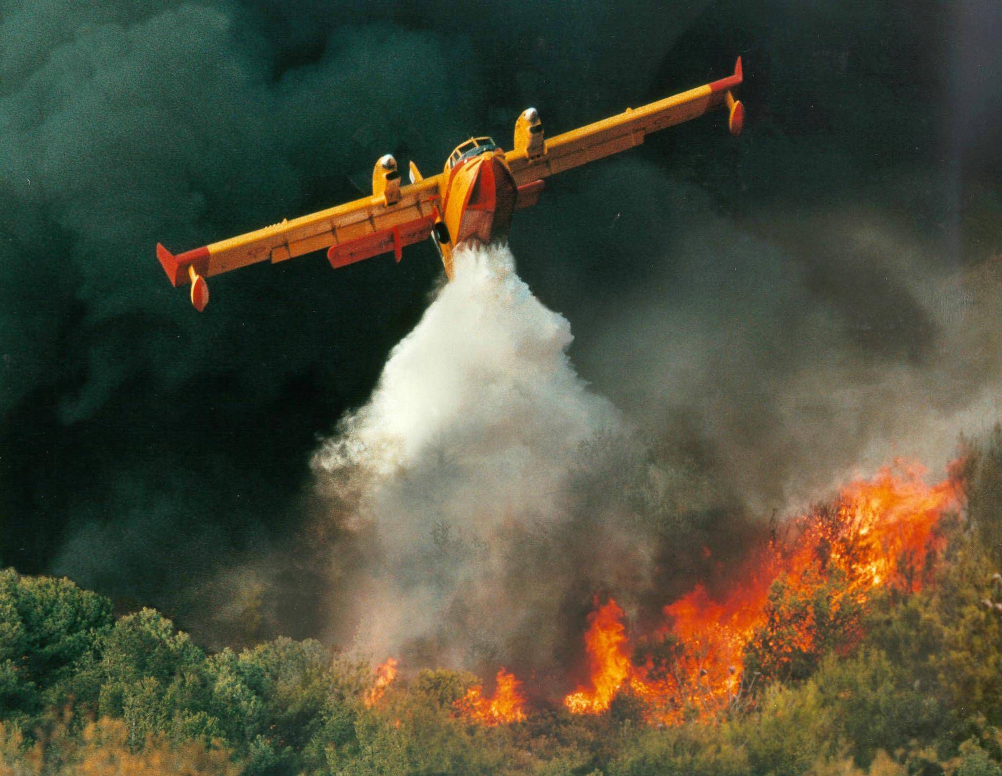

A Conair Convair CV580 can carry up to 7,000 pounds in its 2,100 US Gallon tank. It cruises at 270 knots.

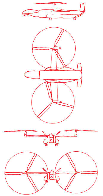

Bell Quad Tiltrotor would combine faster speed with many of the helicopter advantages.

Beriev's seaplane is already very apt for it's mission. Needs new engines, tho.
It's enormous! Not quite suitable for the mission here.
I took this as a challenge to (poorly) "design" a mishmash of some concepts posted here:
If you think about it, the truncated (for low aspect ratio like riggerrob wanted) RQ-4 wings look like the Boeing Vertol 347 wings... (sorry no quadrotor: I felt it's unproven tech and wanted to be as conservative as possible).
However this drawing is for laffs as the scale is incorrect: the RQ-4 is at most 15ft tall while the Chinook is 8 minus the rotor. It mean it still might work but anyway we don't actually need a great deal of RQ-4 subsystems, it might be better to incorporate the MQ-8C systems in the Chinook cockpit (the Bell 407 is around 8 ft minus the rotor)
Let's assume for this scenario the fire is the Henry fire in California, an F class fire (1320 acres) contained on 7/30/21. It's 34 days so close to average for a large fire. (This probably doesn't matter so much though as it should be able to fight any kind of fire)
How far from home base?Not sure, not enough data. ~60.5 miles from Bald Mountain helitack base in Long Barn, CA to fire midpoint (but that's by walk)
What type of terrain around the fire? Sierra Nevada mountain range. Lots of dense forest, 3 nearby lakes and lots of rivers and small streams. When the fire was contained, it was bordered around where large rivers and highways were.
What types of trees and fuel?Douglas Fir, Redwood, Sequoia, etc. Large, possibly old-growth forest
How quickly do we need to extinguish?Wildfires last on average 37 days. Aim for 30% containment by 2 days and 80% by 6 days if possible.
Do we need to knock down the fire with a single drop?I think this is physically impossible :( It would be nice if we had that big of a plane though...
How many tons of water or retardant to knock down a typical fire?Like previous q, retardant isn't dropped directly on fires but around it, to contain it, box it in. Even water isn't dropped directly on, it's dropped right in front
Do we need to be able to refill from a nearby lake or swimming pool? We can, not sure how big the creeks/streams are but the rivers and lakes and reservoirs seem quite large. No swimming pools
How many minutes to turn-around at home base?TBD/not sure. 234 carries a 3000 gal bambi bucket, but that shouldn't take much time to put on, right? Possibly could take some time if rotors need to be unfolded
How long must it loiter?TBD/not sure
How many drops before needing to refuel?Likely several
Does the airplane need to be able to land on water?No
What sorts of avionics: radar, sonar, infrared, synthetic vision, etc.? MQ-8 uses the tactical common data link (TCDL). Things to make Helicopter UAVs fly (I wouldn't know, I work in propulsion and even there I'm bad)
Does it need to be manned?No
How far away van ground crew be stationed?Some around the fire but otherwise back at base?
Will we need another airplane orbiting over the fire to provide a data link?Unmanned, so we might? Firefighters use aircraft like the OV-10 Bronco for recon (they don't drop any retardant), these can be used to guide it
How many crew?Drone pilot
I'll work on a better 3 view (prob CAD) and the math for this in a bit (I generally dislike math). Could also make an excel calculator for some kind for people to experiment with say different rotor blade lengths. This would change a lot of minor factors such as blade solidity and a lot of major factors like whether it'll get off the ground or not. To convert to tiltrotor, I'm changing the blade length to 70% the original (252 in radius) otherwise it'll hit the sides so that's not good...
