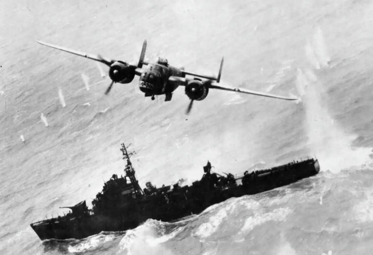

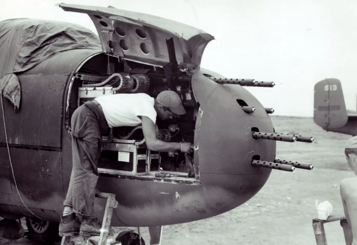

What actually made "8 gun configuration" of B-25 so deadly to Japanese destroyer?
All the guns on the B25 fired directly forward, while the wing guns on the fighters were angled to converge into a single pattern at about 200 yards.
Potentially.
The ground crew gets to calibrate the guns and it's possible to create various patterns. With 8 guns you could very well create a very large beaten zone @ 500 m distance, like 20x20 m with some guns calibrated to aim a bit up, up-left, left, down-left, down, down-right, right, up-right.
The thing about shooting straight forward with central guns and crossing at a certain distance with outer wing guns was all about hitting a fighter in typical air combat shooting scenarios. That's not very relevant for a B-25.

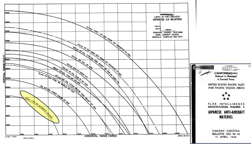

You are correct that guns on the fighters were angled to converge into a single pattern, which make them less effective at longer range against evasive targets such as other fighters. But against soft area targets such as anti aircraft gunner crews, pilots are instructed to open fire at range greater than the converge point. I think mostly because people doesn't need to get hit by more than 1 .50 cal bullet for it to have significant effect on them

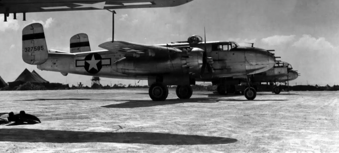

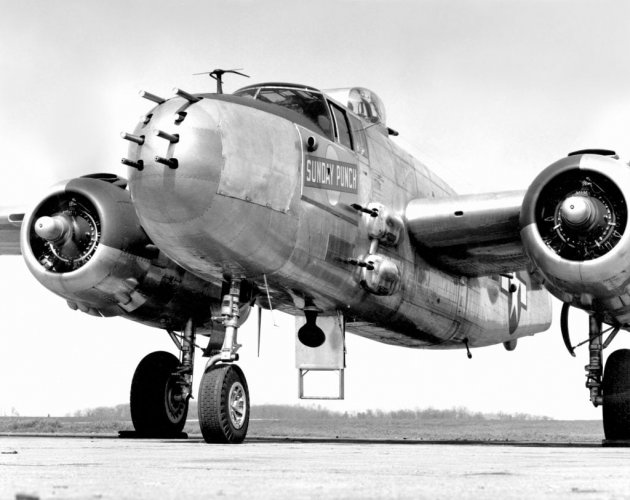

Just read some illuminating information, about the B-25 solid “ 8 gun nose “; at the
B-25history.org website….
A historian there states that B-25J were not manufactured with the “ 8 gun “ solid nose.
He pointed out that the 8 gun nose was “ kitted “ modification, and memtioned that these kits were instead installed at Fairfax; KS on a special “ modifications “ line.
He pointed out that the pic on the b-25history.org website showing a B-25J solid nose aircraft….. was taken on the “ modifications “ line.
As it turns out, at the same website…. If you select “ about “ then select “ restorations “, and then select “ 8 gun “….you will be treated to pics and a delightful story about the restoration of an 8 gun “ straffer “ nose. This nose was formerly installed on
B-25J-25-NC s/n 44-30324.
The website listed 3ea B-25s currently flyable, that have the 8 gun nose.
From what I read, all had their “ solid noses “ added well after the planes had been originally produced. “ Devil Dog “ got the mod, to serve as a civilian freighter
another to become a TB-25J ( albeit w/o the more-familiar point nose cap applied to a glass nose ).
“ Hot Jen “ was given a solid nose to serve as an executive transport.
“ Betty’s Dream “ appears to have had its solid nose installed as a repair after a nose gear failure, before going on to serve as an air tanker.
In the histories and pictures of these aircraft, there are some that had a solid nose that was removed, and as mentioned… those that has one installed… well after the planes had left MIl service. Given the flexibility, past availability, and comparative ease of installation; it is not likely possible to pin-down how many B-25Js left the factory configured w/ the 8 gun nose mod. If some one has better information, it would be something worth reading.

In my opinion, the destructive capacity of eight machine guns grouped in the nose can have the effect of a chainsaw on the hull, on the bridge or on the torpedo tubes of a destroyer or frigate. During strafing operations on D-Day, many Mustang pilots were amazed at the effectiveness of their weapons against armored vehicles, sometimes destruction being achieved by ricocheting 0.5-in bullets off the ground before penetrating under the poor ventral armor of tanks.
