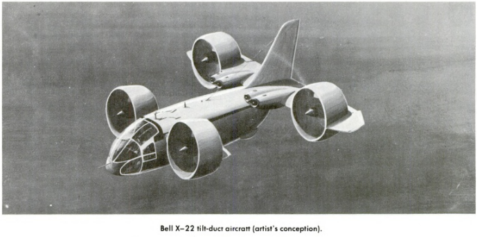

Here's a page from Aviation Week 1965 9-17, showing a test rig, the X-22
tail assembly and an artist's impression of the D-2240 civil ducted fan VSTOL.

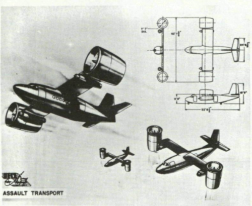

My guesses:
Left design: "Ducted Fan Transport Design:
Right design: D-181... maybe D-190

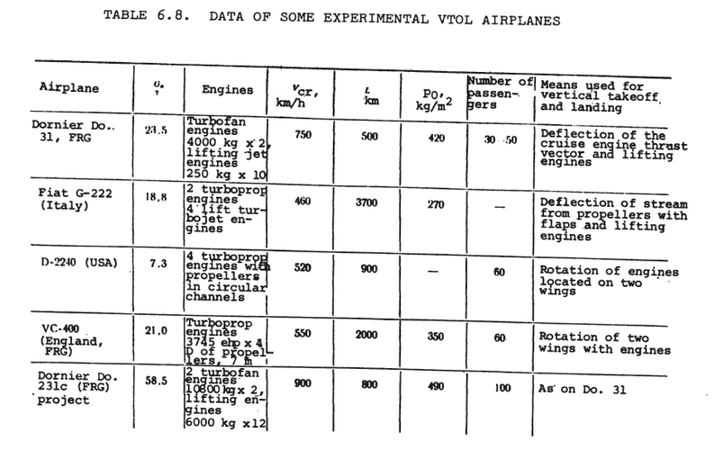

The table given by Hesham above mentions a US program designated "D-2240". It is described as having "4 turboprop engines with propellers in circular channels". At first one would think of another derivative of the Bell X-22 (D-2127, a program which also spawned projects such as the D-2020/2022 or D-2064). But then Douglas also had a similar project on the shelf... at the same time... and their D- series was also in the 2000 range at the time... (a picture of the said project is shown below). So what do you think? Does the chart describe a Bell or a Douglas project?

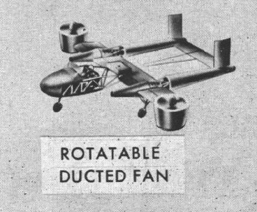

Artist's impression of Bell Ducted Fan Transport.
Keith-Lucas, D. "Vertical Take-Off Aircraft: Some Problems of Design" New Scientist May 29, 1958 p. 59.

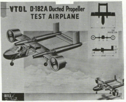

Dear Boys and Girls, here is a picture with a caption in French of the Bell D-182A twin-boom tilt-duct VTOL aircraft "project"......
The picture comes from the 4th July 1959 issue of Les Ailes......

Artwork showing the D-182A:
