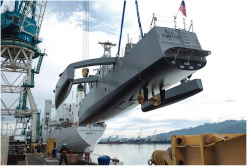

Carbon fiber. Pretty shallow draft. Nice low, rounded and streamlined deck to minimize windage. U-shaped aft hull to reduce pitching. Very slippery. Probably just a itty-bitty blip on radar. Popular Mechanics reported speed trials at 27 kts. Shouldn't need much for engines to run around at those speeds.
Would it be worth fitting an autonomous celestial navigation system should satellite GPS not be available?
I had the impression that the sonar extended below the hull. This picture doesn't show it. Perhaps it mechanically retracts?
