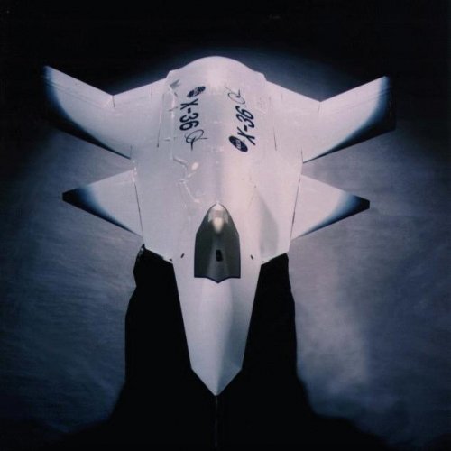

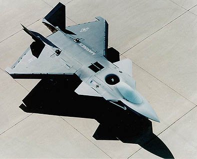

These would have been much cooler JSFs. I did have a BAe canard concept but it's gone. I know a lot of people don't think the X-36 was a JSF but MD would say that after they'd lost. Anyone got any more?
Cheers, Woody

Somewhere I have an article on the X-36 that shows what a Naval version would like, in planform. If I run across it I'll scan it in.
Well, going by published illos of the McDD proposal, there are great similarities, but the two are not of identical planform (as I remember, McDD's entry had tail surfaces similar to the YF-23, but I may mis-remember). I'm told that the aerodynamicists at Lockheed considered the McDD configuration a much more formidable adversary than the Boeing one and it was only McDD's violation of the rules of the competition (separate lift engine after their gas-driven lift fan concept failed utterly - the rules were one engine for lift and propulsion - X-35B/F-35B propulsion system can be considered an extreme case of the "tandem fan" concept) that got them disqualified.
The X-36 was based on an early iteration of McDonnell Douglas's JSF design, produced under its precursor the Joint Advanced Strike Technology (JAST) research programme. While the design continued to evolve, MDC spun off its JAST 1 configuration and built the subscale X-36 as an unmanned tailless-fighter demonstrator.

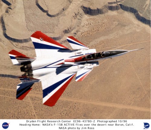

The AFTI program's ACTIVE F-15 with canards (F-18 tail surfaces) and 2D then 3D thrust vectoring is a case in point. It was advertised to address the damaged airfield scenario you suggest but the US seamed to carry out the programme grudgingly and then dropped it without a trace.
Also the rest of the world believes canards aid maneuverability and they did too - once. As I wrote in another thread the new F-35 is only supposed to have 'F-16 "like" maneuverability', a 30 year old design.
www.dtic.mil/dticasd/sbir/sbir022/n189c.ppt
Cheers, Woody
