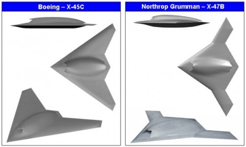

Anyway, you can note how close the Boeing model is in planform to the X-45 C and Phantom Ray with a cockpit stuck out in front and high alpha inlets.
