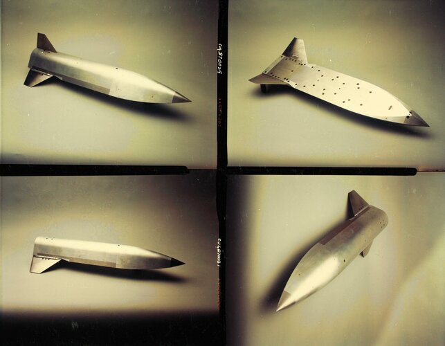

There was a proposal of a Tomahawk with a pointed nose mentioned in Janes in the early 2000's, but nothing seems to come out of it ....
It was supposed to be "supersonic", but other than ramping the engine to max RPM and getting an overheated turbine, I am not sure how they can achieve Mach 1 without substantial redesign ....
Supersonic Tomahawk?
The wing is still dead straight and it looks like a flush inlet so probably not supersonic.
Post #1 in this thread.
The photo above is Convair, so much older. Also, you can see four fins instead of of the later three-fin layout of the supersonic proposal.
The F-104 Straighter had straight wings and it was a Mach 2 supersonic interceptor.
But not the same shape wing that you'd have seen on a subsonic aircraft, while the wing and tail fins on that pointed Tomahawk are exactly the same as the one on the round-nosed and definitely subsonic ones.
Between SALT I and II, there were some discussions of treaty limitations on certain classes of cruise missiles. Possibly this was the sort of visual differentiation required to make that verifiable in imagery.

Now we know, why this Tomahawk model had a pointy nosecone (and also a flush inlet), since it was to reduce its radar signature.

SDASM released a whole string of images tagged as Tomahawk that definitely are NOT the Tomahawk we know and love. Mach 2+ (the wind tunnel slides say between M2.36 and M2.80, I think) with a chin inlet and wrap-around wings and tail fins. I wonder if these might be that Navy Supersonic Tactical Cruise Missile mentioned as a semi-competitor to ACSM above.
