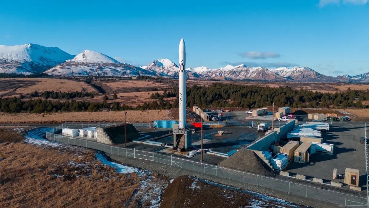

US - Long Wall Exo-Atmospheric Interceptor
Ah, this used to be ABL Space Systems. They didn't do so well as a commercial launch provider.
https://orbitaltoday.com/2025/02/25/abl-becomes-long-wall/
Trying to grab some of that Golden Dome money, I'm sure.
