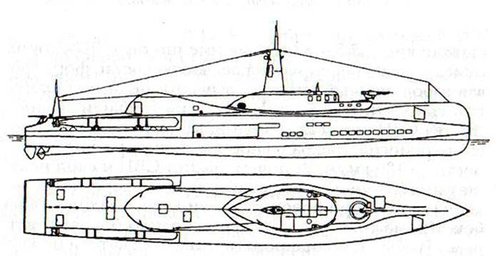

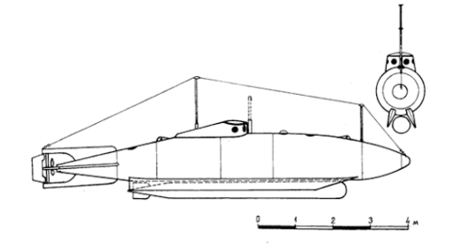

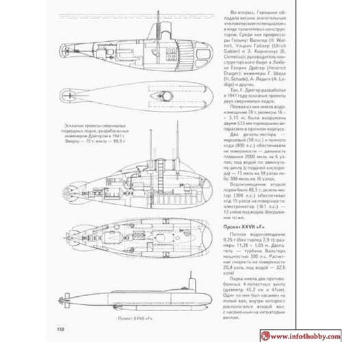

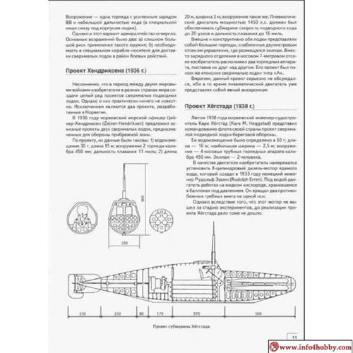

I have "discovered" the following images in my files and I need some clarification. I would like additional information regarding the "Blokha" (flea) midget submarine design. Secondly the two images, in Russian, illustrate some interesting designs. I do not read Russian and I am hoping that at least two of the 1936 projects illustrated are Soviet pre-WW2 projects. The others look German to me. Please help me clarify what these are and, if possible, provide a translation and additional information.

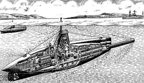

The first two are Norwegian, the second are Germans. Third is a "Blocha" ("Flea") diving torpedo boat, designed in Leningrad in late 1930s. She was supposed to use both speed & stealth to attack enemy warships. The prototype was laid up in 1939, but were stopped when the war started. During the blockade, the incomplete boat was seriously damaged by German shell hit, so in 1945 it was deemed a total loss and scrapped.

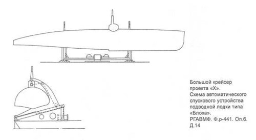

The fourth is the scheme of transporting the "Blocha" onboard the large warships to enemy harbors.

60-ton submarine, like a Type M (VI) serial submarines, but, with habitability and navigability worse than Type M (VI)
6.5/14.5-ton one-man submarine, with two 450 mm torpedoes and one machine gun.
"Moskit" (mosquito), project of engineer B. M. Malinin, between APSS and "Bloha".
