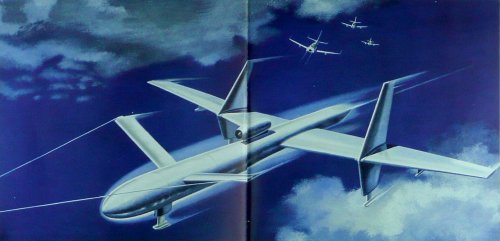

_Del_ said:Perhaps the engine is less for propulsion and rather for generating power needed for a hydraulic system which produces a minimum of thrust? A compromise over adding more "dead"-weight to a towed-target?
Kartek said:I was wondering if it was to simulate IR eflux but 1952 seems too early for that sort of thing either for missiles or IRST practice.
Well the newspaper article is from '52 and I know we had early IR ideas but it still seems too early.Jemiba said:Kartek said:I was wondering if it was to simulate IR eflux but 1952 seems too early for that sort of thing either for missiles or IRST practice.
... at least, if we take the gun firing Sabres literally !![]()
