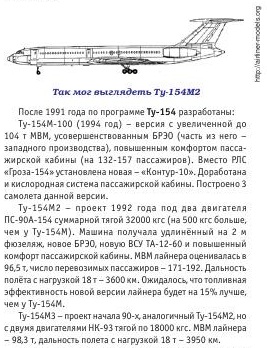

Anybody has drawings of that twin engined variants?

If you read Yefim Gordon's book about the Tupolev Design Bureau, you'll find a drawing of a twin-engine version of the Tu-156 hydrogen-powered derivative of the Tu-154, the Tu-156M2. It is possible that the lack of funds following the USSR's collapse rendered the Tu-154M2 a paper project only.

From last "Krilya Rodiny" Russian magazine;
As, You may see - nothing extraordinary.
