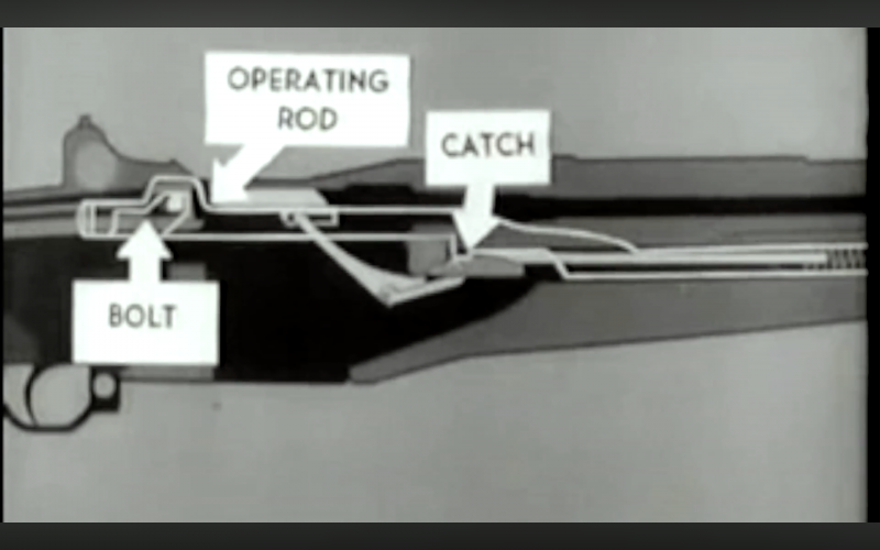

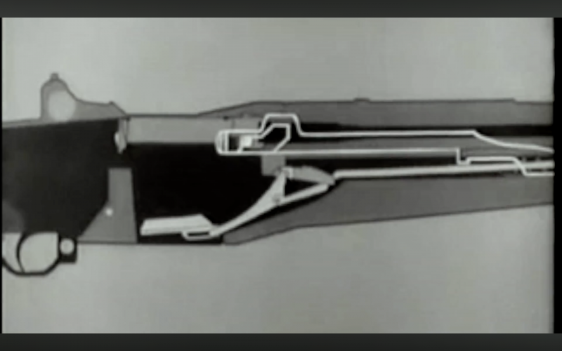

The M1 Garand uses a simple anti-pre engagement system of a track along its top opening with a recess at the end. Here the Right side locking lug, with the operating lug on top of it, can enter. This operating lug is of great importance to this thread. This operating lug is operated (pressed back, pulled forwards and cammed up and down) by the operating rod.

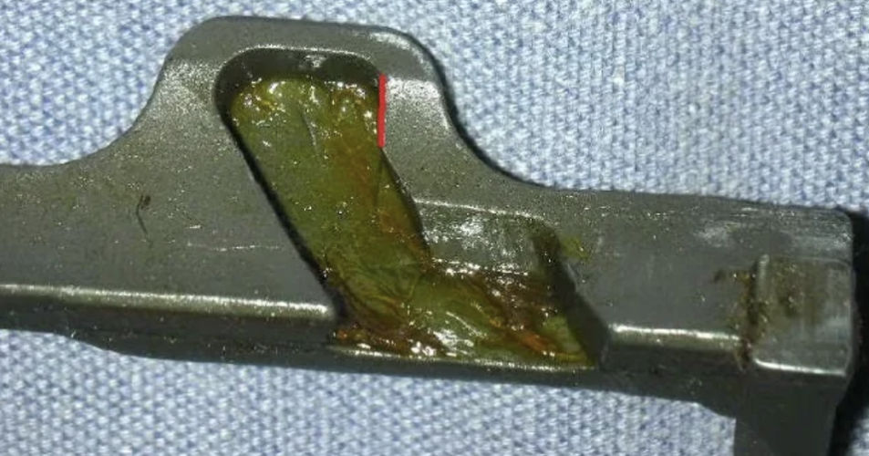

At the end of the rod is a track. I found this on a TFB thread. But I do not fully grasp this in the AK. The red line was said to be a "Shelf" This track is on the inside, facing the rifle. The shelf is what the lug leans on when cycling forward again, if the bolt hits an obstruction or grasps another case, this shelf supports the rear of the oprating lug.

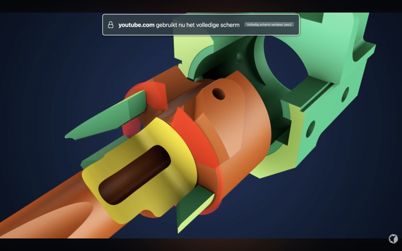

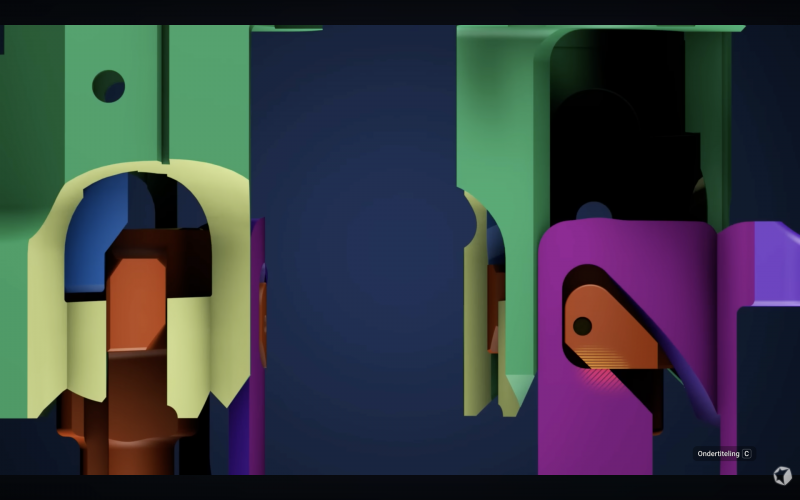

Enter the AK. There is a cam surface in the receiver, this appears to be a pivotal solution.

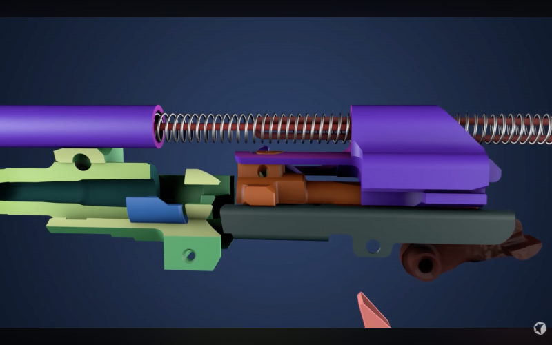

Next the operating lug slides of the anti pre engagement track inside the receiver. But the bolt rotates in opposite direction. To still prevent the bolt from rotating when it hits the next cartridge in the magazine, cycling back or returning, there is a similar "shelf" in the bolt carrier track.

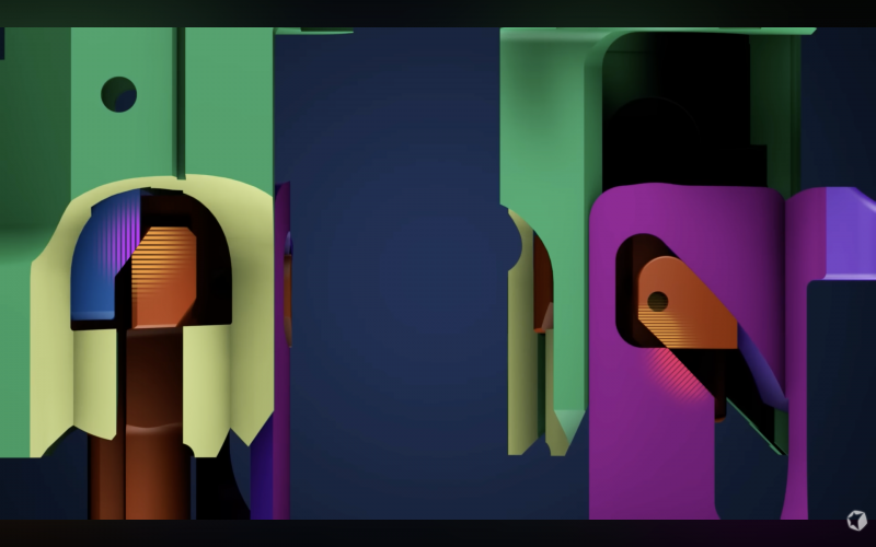

The picture shows side view with the blue and top view with the purple. The carrier track is displayed in the purple. The lug inside the carrier is leaning against a support with its flat rear The blue cam track on the left diagram we already see in previous diagram. The bolt really needs to be cammed before it will rotate. the next diagram reveals that.

The track in the purple and the cam track on the operating lug are identical. It operated on the side but if it had from the top, it is exactly the same direction. The garand operating lug must have been lifted up further than the locking lugs somewhere in its trajectory.
The blue cam surface was also present in the M1 operating rod cam track. But only in sofar as the op-lug being up high when the bolt is in the rear. This is simply because the recoil spring is diagonally placed in the stock, a stock with a grip which does not afford a straight recoil spring.
Then cycling forward, the lug must follow the track in the receiver, or slide over it, so the op-lug drops slightly in the track. Meaning it slgihtly leaves the shelf downwards. The op-lug forward reaches the recess, the op rod travels further then the op-lug, now it is forced to cam the op-lug down to rotate the bolt which also reached its end of travel in the barrel extension/ breech.

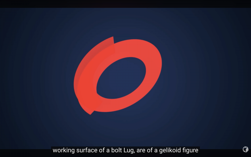

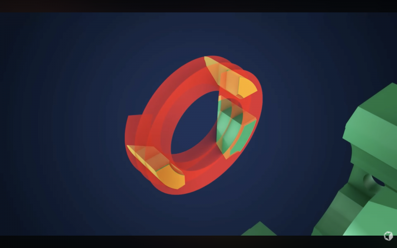

The third question is this gelikoid figure. It renders Kalashnikov into a genuine Einstein. Is this actually something real he invented intentionally, or the result of some massive form of analysis and by such, if so, is it real in application?
I never heard of it. I got all this from the video: "How an AK 47 works", by a channel named Weapon mechanics. Which you would probably need to watch to have your mind boggled or fried. Well i mean to say, here my mind did get fried and now I need someone else to explain it to me, that is, if it were actually a thing.
