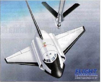

The Pathfinder Rocketplane was capable of lifting
three people to an altitude 99.2 km.
http://www.flightglobal.com/FlightPDFArchive/1997/1997%20-%200624.pdf
Ah, those were the days. I designed that friggen' thing, then watched one of the three founders of the company go completely buggo and destroy the whole effort. Bah.

I recall being fascinated with the Pathfinder concept for many years. My biggest question was how they planned to protect the turbofans during reentry.
All versions had some form of closing door. Some were rotating structures, some were "flaps."

Gallagher I never met. I believe he came onboard after the split (when I suddenly found myself *not* working for Rocketplane, as my boss was no longer working there either). Raymer is a prolific conceptual designer of aircraft and was, I believe, hired as a consultant, producing a number of designs for PR. He designed:
That last one I created some crappy "art" (the light gray images):
I had previously designed:
I also produced that bit of what I jokingly refer to as "art."

I was checking out the Pioneer Pathfinder paper from Mitch Clapp that was published by AIAA in 2002. It looked like the plan was to actually perform two refuelings per mission. The first tanker would top off the kerosene tanks, and the second would transfer the LOX. I guess it would be too expensive to modify the tanker to transfer both at once.

Yep, I joined Pioneer in California about the time Scott left. In my configuration manager role (among other hats) I numbered the different designs in order. Scott's (engines along wing root) was 1.0. Dan Raymer's (engines on top) was 2.0. The color CAD image above is of 4.0 (engines back on the wing roots, but four small rocket engines added in pairs alongside the main one). The 3.0 design didn't last long, we had to freeze for a NASA deadline before doing a real analysis on it and it wasn't stable on reentry with payload in.
