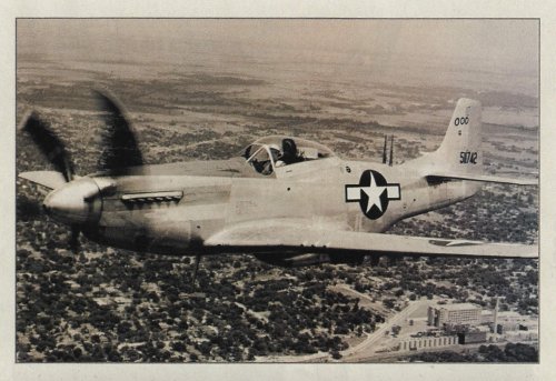

Thanks Steve. Here is the picture in question (the aircraft is described as the last built P-51D...).
Re: P-51M discovered
Here's the correct info - i stand corrected. -SP
Steve,
That photo is the last P-51D built at Dallas, according to our NAA records, 45-11742 was the last P-51D - that photo was taken around Aug. 1945.
The P-51M was 45-11743. Have not been able to find any photos or other information on the illusive P-51M, the only notes we have on the P-51M is that it was used to test the Merlin V-1650-9A – there are unfortunately no records of any flight tests.
I know there are a lot of stories about the P-51M but I have not been able to substantiate any of them.
Michael Lombardi Corporate Historian - The Boeing Company

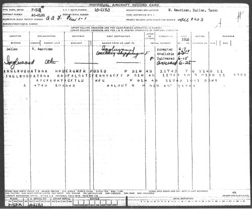

I got an IAR Card today on the P-51M 45-11743. It only says the airplane was accepted 6/7/45; delivered 6/15/45; arrived 6-25/45. But it proves the airplane did indeed exist. -SP

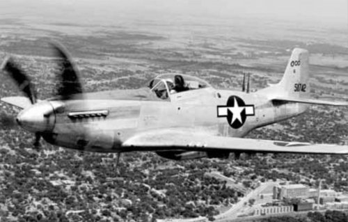

Found another last production Dallas-built P-51D-30-NT image like above image with s/n 45-11742 on it. -SP
Steve,
