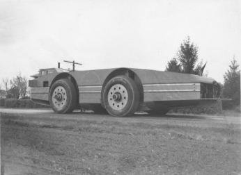

Aha!
here's something from Pre War (the second one) America.
This baby was seen as the best option for Transit in Antarctica.
Take a look...
http://blog.modernmechanix.com/2007/08/26/planting-the-stars-and-stripes-in-the-antarctic/
Pics from here
http://www.joeld.net/snowcruiser/snowpics.html
and
http://upload.wikimedia.org/wikipedia/commons/4/48/Antarctic_snow_cruiser_cutaway.jpg

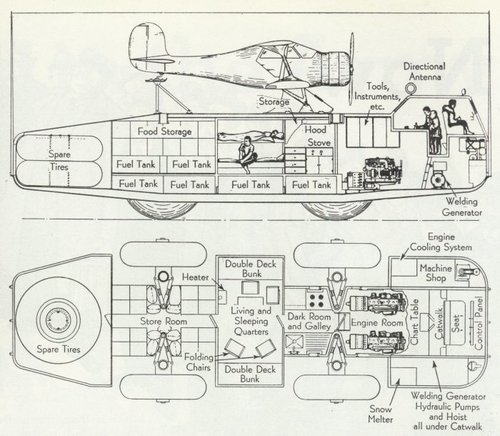

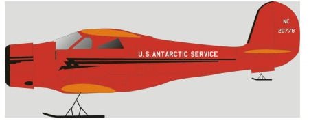

How it was suposed that light aircraft to be stored in the roof after operation? A winch?
RanulfC
Mar 6, 2009
926
374
Wooden ramps and a winch on the roof of the Cruiser to pull it up. The Planes wheels would sit in a set of depressions on the roof and the Cruiser had tie-down points to secure the aircraft. IIRC they wrecked the ramps trying to use them to move the Cruiser from the ship and the plane didn't make the shipment timetable.

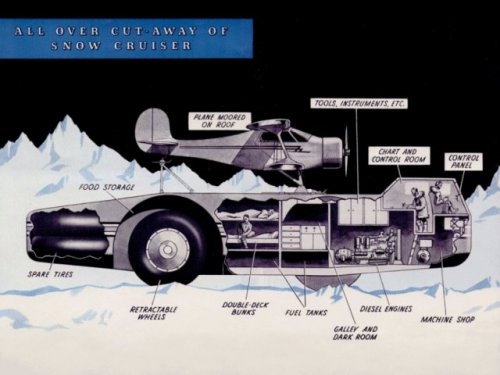

The Artist
Nov 2, 2009
638
255
One little detail in the image snowcruiser_05.jpg caught my attention. The kitchen doubles as the darkroom? I spent time in darkrooms in my younger days. I have to wonder how any lingering traces and odors of the darkroom chemicals would affect the taste of the food.
