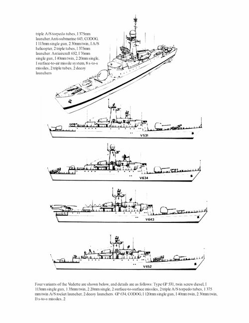

Or if instead of the T21 the RN had opted for the simpler Vickers Vedette design and built 16 of them to replace the old frigates built in the 50s?
