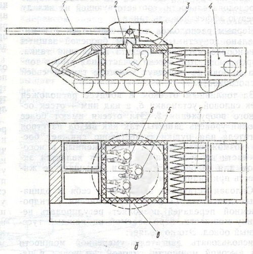

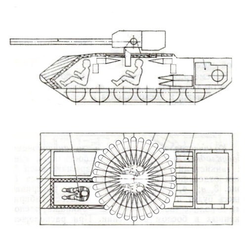

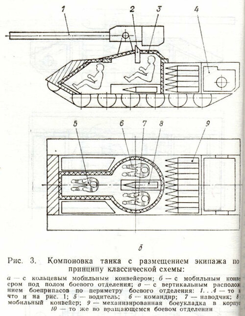

I used some pictures from Vestnik BTT (Armored Vehicles Gerald, restricted acess magazine of Soviet tank industry) article from 1991 on autoloaders and layouts to somewhat visualize them.
1 - one he proposed in 1972, and only one for which pics of scalemodel are available
2 - autoloader behind crew was replaced by circle autoloader on the roof level. 24 rounds; where exactly were stored 36 more - was not mentioned, along with location of fuel.
All 3 members of crew were still sitting in one compartment, somehow next to each other. It's unclear to me whether anyone was rotating along with gun in this version
3 - designers switched to traditional layout, with driver in front (to the left or in the middle - nor mentioned), and two members in turret basket to the left and right of the gun. Still autoloader under roof, but this time with 30 rounds (not 32 like on my picture); 30 more were somewhere else.
It's kinda close to 225, and weight was either about the same - barely fit into 42t, or more /44t were mentioned/
Г-shaped two-piece ammunition on pictures depicting variants 2 and 3 is based on this Morozov's drawing from published edition of his Diary which presumably depicts variant 3.
