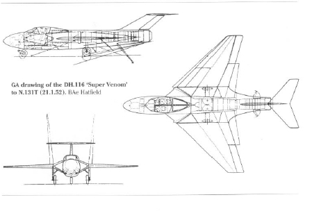

Would this be the Super Venom:
dh-116-jpg.277076
This one, exactly. Looks it could have a big production run.

I'm a bit sceptical about accepting brochure figures uncritically. The DH.116 was a cut-price offering too, using bits of Venom to save development time and sacrificing armament and endurance for size. It was decently equipped though and its interesting to speculate if the FAA would have switched to an AAM armed version using Fireflash.
I think the RAF would have been pretty wedded to Swift and Hunter, and as for future developments the P.1083 would have outstripped the Super Venom. Of course a single-seat DH.116 was possible but there's no brochure so we can only guess at its performance and de-navalising would have taken time and money. You rightly point out radar gives an edge, but the AI.21 was not pilot-operarable and the AI.23 is still in the future and there is already the P.1B looming up in the wings. As an AW type the RAF wanted endurance and that's something not so easy for the Super Venom even if you load it with tanks and a refuelling probe.

A tandem seater would spread the Cross Sectional Area increase more gently (inside the perfect sphere) but might actually increase weight.
Would there be any advantage in a tandem seating layout rather than side by side?
Perhaps a slight aerodynamic improvement, given the top-view posted above it doesn't look likely that the fuselage cross section would be that much smaller, the Venom cockpit was quite narrow and hardly ergonomic as you can tell from the staggered seats.
Plus you loose commonality if DH are hoping to stick on stock Venom NF fuselages on.
Of course you could argue if DH went to the hassle of a new engine, new wings, new tail and new undercarriage then why not develop a new nose?
If they had drawing office staff to complete the design, then logically they might then change the nose and cockpit as well.
Possibly only the prototype might fly with the older elements.

The only parts of the Venom which were to be reused was the cockpit and air intakes. One account I read stated the only parts to be made of wood were the air intakes. Like the first Vixen models. The cockpit was to be fully metal.
I would be worried about deep stalls with that design, where rough air off the wings blanks out any lift or tail authority that T-tail might have. Pull up hard enough to stall that main wing and the T tail is going to be right in the middle of that ugly air.
