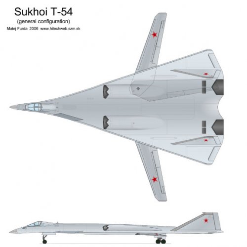

Matej said:
Of course, only T-54 had doble path jet engines, they were quickly abadoned and T-60 had conventional.
Hm, T-60 had this weird two-tube stuff, Mato. And I'm not sure if T-54 had.
So why it was so many times redesigned? Wasnt the goal of the first redesignation elimination of this engines and VG wigns under fuselage? ???

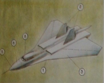

After some simple computing (with help of people around me) I realized that VG wings that I draw were uselessly big. So if they should be smaller, I was able to move them backward and that created much space in the center of fuselage. On the other hand, problems with landing gear are worse now. But in non-engineering point of view, it looks nicer now :)
I know, as was done this figure moreover, I advised the artist
Configuration is similar, but it is not precise. Everything which is said about T -60 - according to larger degree correctly. But then project was reworked, after receiving the new designation T-54 of form they became not simply more beautiful and more elegant, they became those more chopped as to F -117. when I still it worked in Sukhoi OKB, in it went several projects:

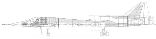

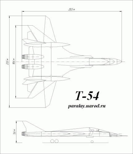

A recent drawing from paralay's site at http://paralay.narod.ru/t60.html. I'm posting it here because narod.ru seems to have problems with files over 100 kB (at least for me).
Anyway, I still wonder whether this drawing best represents the T-54, T-60, or T-60S?
According to the ex-Sukhoi employee, T-54 succeeded the T-60S project - perhaps when the T-60S designation became public (the same thing happened when S-32 designation appeared in public, and Sukhoi changed S-32 to S-37.
So instead of
T-54 -> T-60 -> T-60S -> second T-60S
it should be
T-60 -> T-60S -> second T-60S -> T-54
and thus paralay's drawing would represent the T-54 with AL-41F engines and somewhat altered wing system.
And the T-60 would be something like Matej's drawings, with wings sweeping under the fuselage and those 'double-path' engines.
And the T-60S would be the MiG 701 look-alike with fixed wing and canards.
Did I get it right to at least some degree? :)
Oh, and which of the above would have had the B-2 style intakes?
My drawing represents the initial design transferred from TsAGI to OKB Sukhoi. No matter its number.
Paralay maybe tried to draw, how final design from early 90s should look like.
Paralay's drawing seems to be based on this drawing, which is reportedly from TsAGI. But like Metej said, it seems to represent a more advanced stage of the design than the drawing he posted.
Paralay's versian is interesting, but the air intakes don't seem quite right. Too small, and maybe located where the air flow would be greatly disturbed by the wing.
--Gavin.

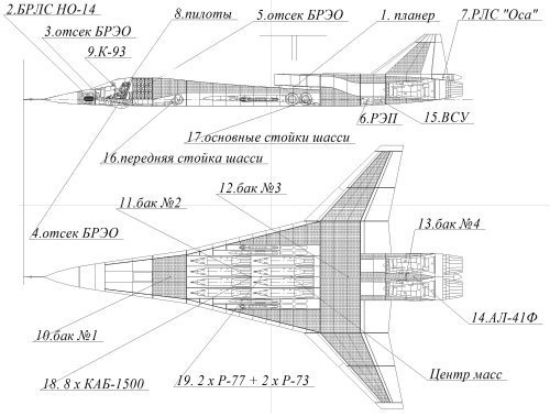

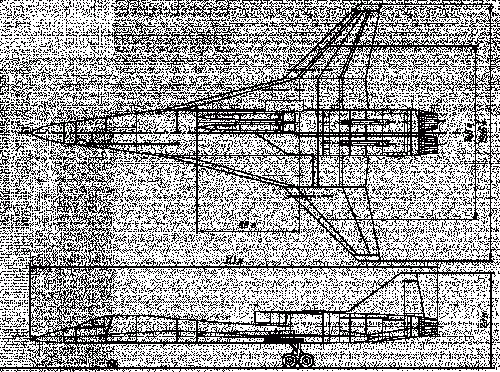

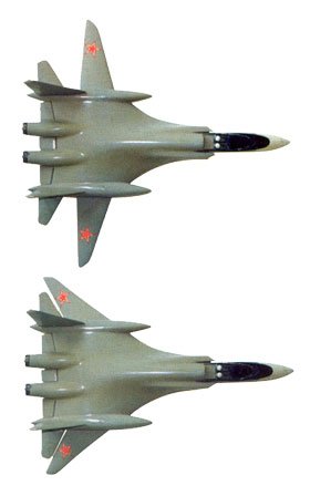

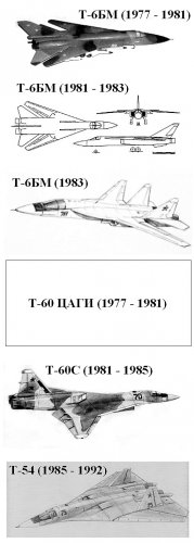

http://www.aeroreview.ru/?/pages/ako/ako_200501_032037/ako_200501_032037.htm
Very interesting ... but can anyone help with a translation ???
Thanks, Deino :)
About Т-54 there anything is not present.
If to make the drawing on this picture that we shall receive:
Length about 25 meters, wing span about 25 meters, engines AL-31F 2 x 12500 - 13600 kilogram.
Takeoff weight of an airplane nearby 50 - 60 tons, is no more!
Not clearly whence the information about 80 - 100 tons has undertaken. :eek:
... In 1985 studied versions Су-24ММ (« small modernization »). The first - with the take-off mass increased by 2000 kg and the increased range owing to installation new, more high-power and economic ТРДДФ АЛ-31Ф. The new airplane distinguished the additional air intake above a fuselage that has been caused by the increased air flow at АЛ-31Ф. The second version was advanced actively by representatives of the Air Forces. It{he} provided increase in range due to unprofitable{superimposed} conformal fuel tanks still before it was applied by Americans on the F-16. One of authors of idea was V.R.Kovtun. However activity on Су-24ММ and do not send{have left} from a stage of design researches. Probably, it{this} was promoted not by absolutely successful name of the machine{car}: local funnymen deciphered an abbreviation "MM" as « the Deadborn Monster ». Other version - «Му-му» (a dog, as is known, under the order of madam too have drowned). Probably, the reason was much more "prosy" - even in spite of the fact that Су-24М, unlike Су-27ИБ, is capable including « on a supersound » to execute{design} low-level contour flight, for ОКБ was more expedient to advance Су-27ИБ, though cost of operation even usual Су-27 above, than Су-24М...
Thanks, but whats's that strange "Ako"-design ... ??? Just another iteration of the Su-24BM ?
Cheer, Deino
Yes, is Su-24BM

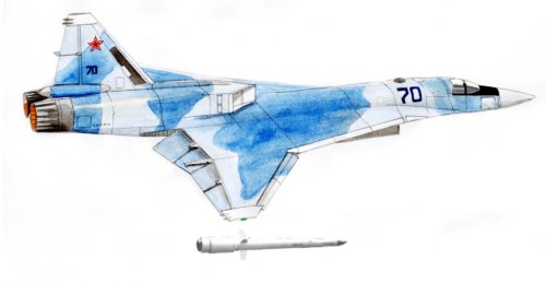

but lok that, is project 701 launch a KS-172 missil.

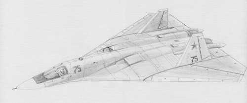

Thanks, but I think for this MiG long range interceptor I.701 is a seperate tread !
Deino

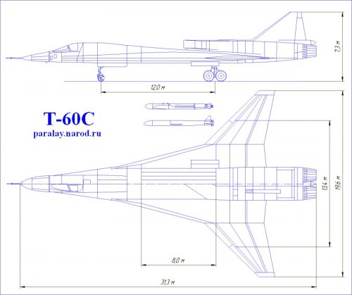

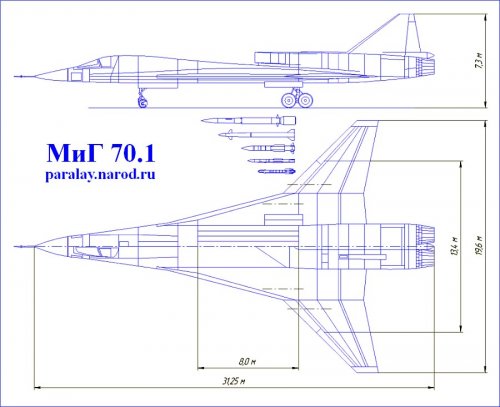

Prospective differences MiG 70.1 and T-60S.

It's either been a long day at work or I'm just confused- the MiG and Sukhoi designs look identical to me?
Yes. because as it's stated chief designer (Samoilovitch) was the same
Samoilovitch has left Sukhoi OKB after conflict with Simonov in late 80s, and brought his favourite baby - T-60C, to Mikoyan, where it's aerodynamic design was implemented now as 70-ton class LRI (info comes from Paralay site)
