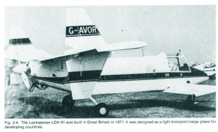

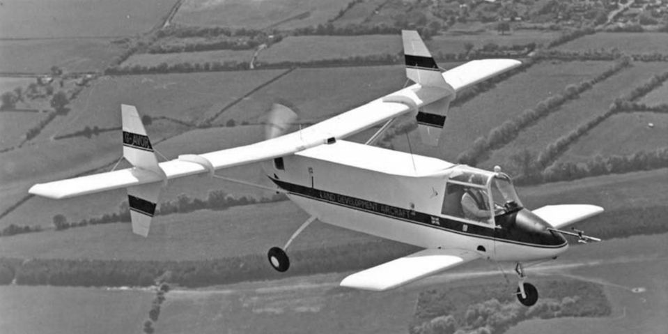

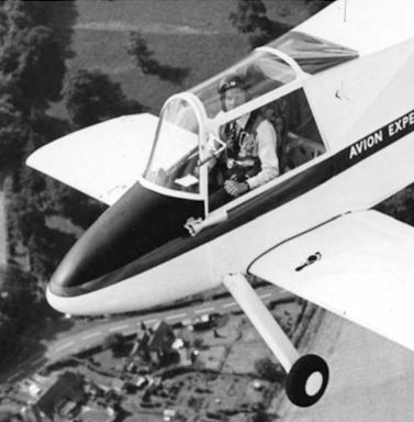

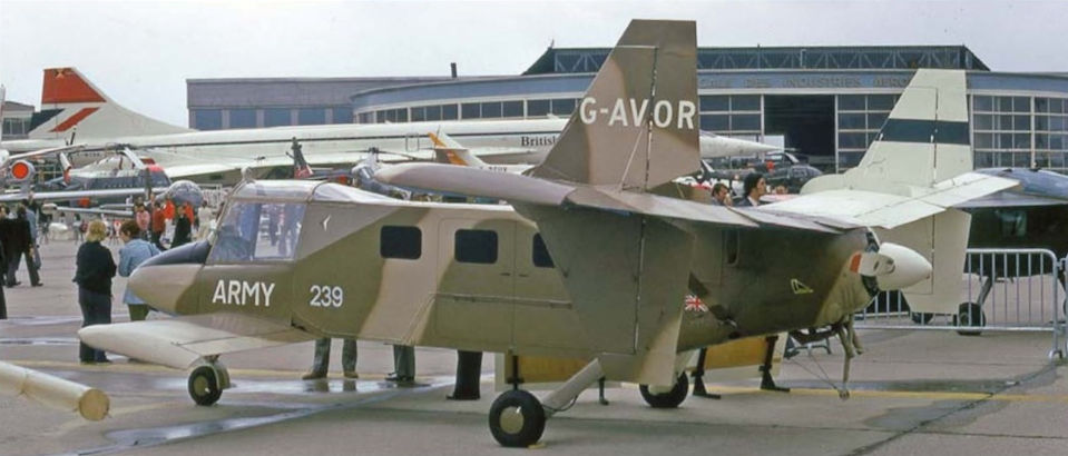

Ooops, perhaps the Lockspeicer LDA, in exibition at the 1975 Paris Air Show, can be a candidate.
Ah, I was getting worried there for a minute. ;)

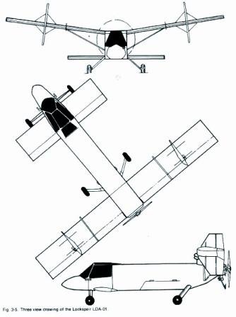

I had forgotten about the Lockspeiser LDA-01. My memory says and Wikipedia confirms that the model that actual flew was a "seven-tenths scale research and development aircraft, which was designed and built by David Lockspeiser to prove a concept for a low-cost utility transport." Does anyone have any info (ideally specs and a 3-view) of the planned production model?

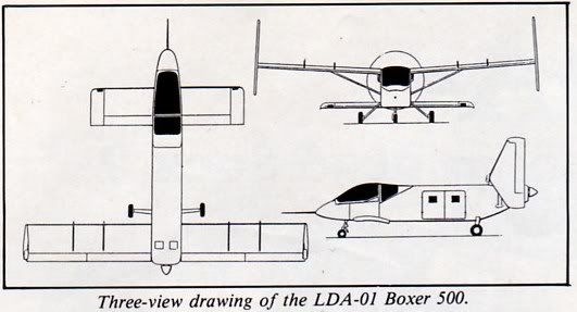

Only a 3-view of the prototype.
I was looking this airplane up the other day on the Flight archives. It was marketed as a "flying Land Rover". There are a few articles here and there, but no cutaway, which would have been interesting.
There is also a blurb in "macchine bizzarre nella storia dell'aviazione" by Enzo Angelucci. Just a few technical data. I'll post it when I get to my office on monday.

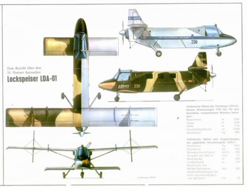

Thanks Retrofit and AeroFranz. I would be very interested in info on the proposed full-scale version as the design has always seemed a bit odd to me. If the cargo weight was to be placed in the fuselage roughly centered between the cockpit and engine, it seems that the CG would have been awfully far forward. I assume that the weight distribution in the proof of concept model was different and the production model would have moved the wing forward or the engine back some, but I have never actually seen what Lockspeiser had in mind.
Here's a colour 3-view from FliegerRevue 1973. Green "Aircraft of the World" 1972/73
gave the following data for the series version:
MTOW 2040 kg, 1 pilot + 6 pax, or two stretchers, 1 Lycoming O-540 engine, span 13,41m,
length 10,51 m.
it says in my book that the LDA-1 (as opposed to the LDA-01 prototype) was to have the following characteristics:
span 13.41m
Length 10.51m
height 3.72m
Empty weight 680kg
Takeoff gross 2,041kg
Powerplant Lycoming O-540 340CV
Cruise speed 245 kph
Minimum speed 75 kph
future developments would have included a twin engined 12-14 seater variant with rear door, tricycle gear
Thanks, AeroFranz, that's very interesting. Look at that empty/gross weight ratio, wow! Replace the piston engine with a derated Rolls Royce (Allison) 250 turboprop, the empty weight would drop even more and the engine would run on biofuel or what have you. That's about 56 kg fuel per hour at 50% power so you could have a 6 hour endurage with reserves and still carry a metric ton of cargo. Nice!

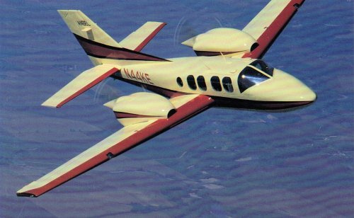

Evangel 4500. http://www.evangel4500.com/
Here's a picture of the Evangel from Aerofiles (see attachment).
I've still got the original brochure of the first model (simply called the Angel) somewhere. When I find it I'll scan it.

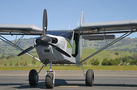

I think the Kodiak (Quest Aircraft) was developed with financial support from Missionary and non-profit relief organizations. The Kodiak is in production and I understand that every 10th aircraft is made available for Missionary work at cost price.

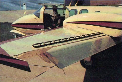

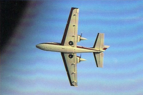

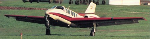

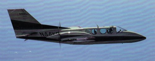

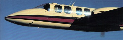

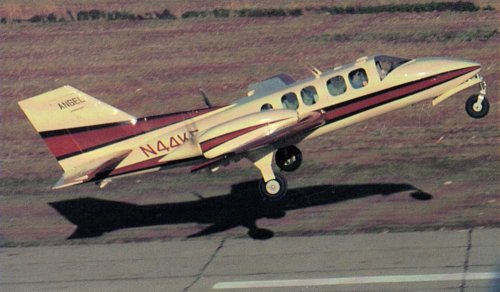

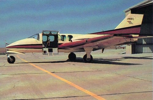

Here is a series of pictures of the Angel Aircraft er... Angel. Name of the company, name of the aircraft!
All these pics were taken from the original 4-page promotional brochure, which I'm also adding here in PDF form:

Thanks, Stephane, interesting pics and a neat airplane, though I never understood the logic of putting the props immediately behind the main wheels on an aircraft indended to operate from unimproved strips.
Mole
If everyone used logic in aircraft design, this site would be smaller and less interesting than it is.
I would imagine that the pusher configuration was selected for safety - imagine using that extra-wide cabin entry with propellers from a conventional tractor installation spinning less than a foot away...
True enough, but then the extra-wide door could have been behind the wing.

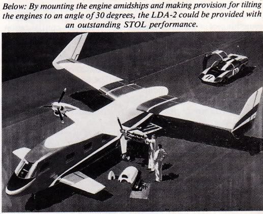

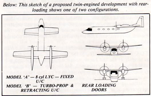

Article from AIR International, Aug.1991:
Regarding the bottom illustration; in the future do people drive race cars to the airport, or has the aircraft landed on a racetrack for a little quick engine work?
I rather suspect it's going to be transporting the racing car - bit far from the "helping underdeveloped countries" brief, dont you think though.... ???

Lockspeiser...
Years ago, I exchanged some letters with Mr Lockspeiser. IIRC, one reason for the 'voluminous' fuselage was that one aircraft would be able to carry complete engines, wing panels etc into rough fields where another was stranded...
That was good thinking.
By the way, I suppose the tilt-engined proposal would have been known as the LDA-2 Model 'C', if it had proceeded any further?

I just got back from the Reno Air races and Mission aviation Fellowship was showing their Kodiak http://en.wikipedia.org/wiki/Quest_Kodiak a brilliant plane.

Cessna Caravans are used for missionary work, but Quest Kodiaks are preferred because they climb better than early (600 hp) Caravans. Several companies (Blackhawk, TexasTurbines, etc.) offer engine upgrades for Caravans to improve STO performance.
