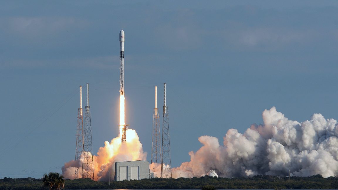

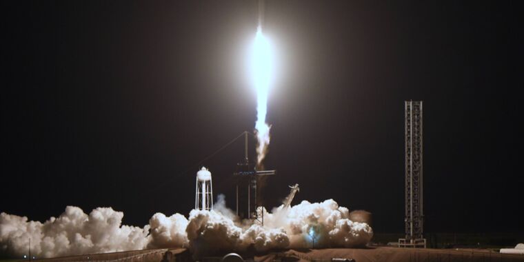

Today was 310th launch of Falcon 9.
Bring the 30th Dragon mission to ISS.
and 26th launch this year.
This year Falcon 9 will past the launch numbers of Titan rocket of 368 !
