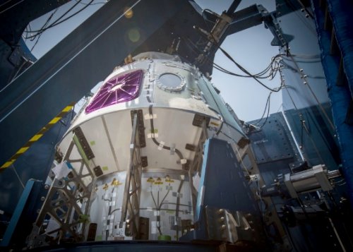

In the meantime, Dragon crewed capsule is undergoing load tests. I think Boeing and Spacex are still planning on a 2017 first flight (unmanned) for their crew transport capsules.
