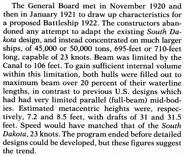

You may be referring to "Battleship 1922", a descendant of the South Dakota (BB-49) class. I believe it it documented in Friedman's "U.S. Battleships: An Illustrated Design History", pg 166. She would have been about 1300 tons heavier than BB-49.

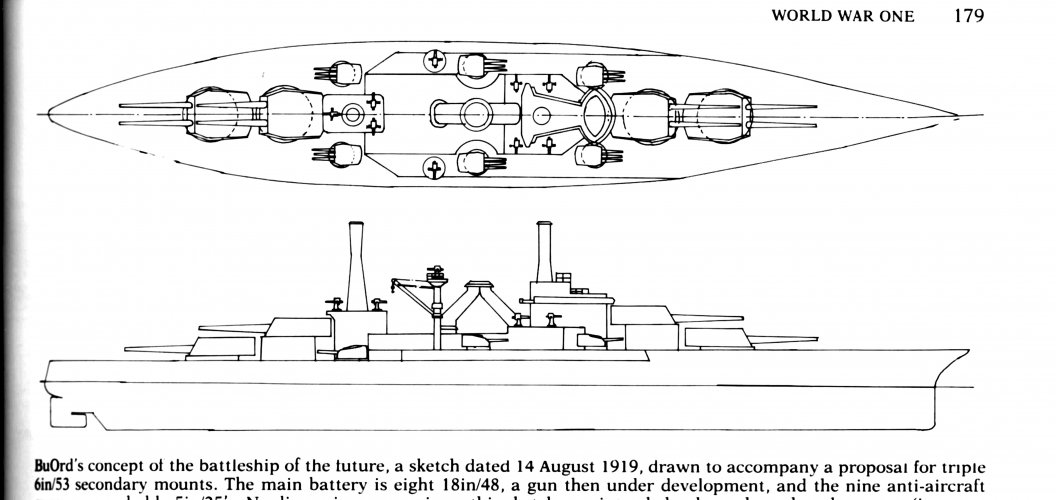

Also, Friedman shows a drawing of an 18" gunned battleship (dated 14 August 1919) that looks like a South Dakota relative, (pg 179, IIRC) but the drawing is from the Bureau of Ordinance, not the Bureau of Construction and Repair. My pet theory is that the Bureau of Ordinance was showing what weapons they could build.

Friedman provides very little, but does indicate a displacement of 44,500 tons. (compared to 43,200 for BB-49)
Regarding the 1919 BuOrd drawing, there is no data.
