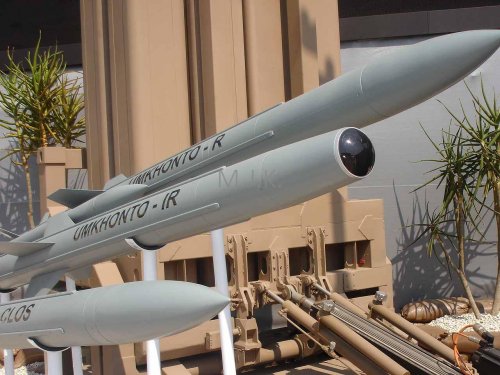

One of the many developmental weapons the article in the link posted above talks a bit about is Umkhonto (Zulu - short stabbing spear) long range radar guided version. Here it is posed above two models of the short range and in use Unkhonto IR (South Africa, Finland and soon Algeria), and a cheap CLOS option (not yet sold). While the range of the IR version has just been increased to 20 Km, there has been various mention of the longer range radar guided version being in the 45-65 Km range class. Initially they had developed a standard type booster attached to the rear of the radar missile to obtain the extended range, now they seem to be opting for twin boosters on the sides of the missile - I would assume this was the only way they could ensure it was compateble with existing launch tubes.
As per the article in the link above, the radar seeker they are busy developing will also be used (maybe slightly modified?) in the new Marlin long range air-air AMRAAM type missile that they are also busy developing.

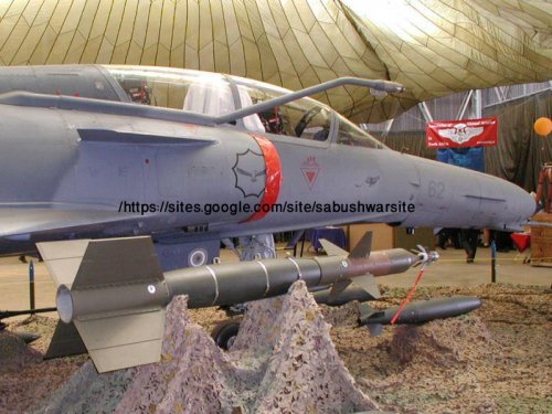

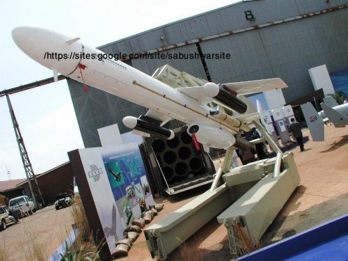

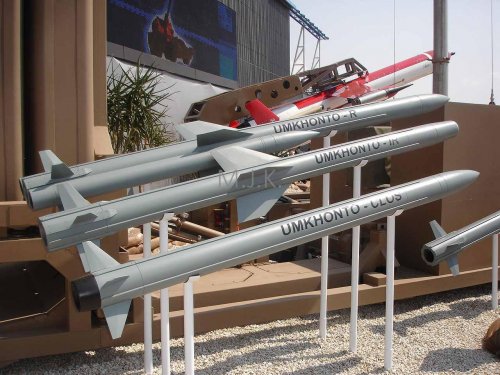

Pics taken at AAD 2012.

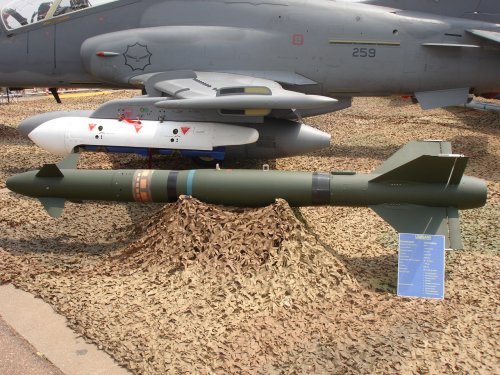

I think that is the GBADS ground based SAM launcher unit in the backround?
That earlier link you posted was interesting, stressing that the AAM missile itself, not the project, is called Marlin.
Quite correct Kaiserbill, that's a GBADS ground launcher in the background - moving onto another, here are some photos of the prototype Umbani (lightning) PGM, the first pic shows it without the range extension wing kit the 2nd pic with it attached and extended. It has now been ordered and is being jointly produced by Denel Dynamics and Tawazan Holdings in the UAE, after a $490 million order was placed by the UAE for the Umbani - now re-named Al-Tariq for use on their Mirage 2000-9's and perhaps also on their F-16 E/F Block 60's. - link regards the Al-Tariq purchase and it's ramifications - http://www.defenseindustrydaily.com/new-options-denel-tawazuns-precision-weapons-partnership-07551/
Note the copper coloured antennae around the front portion of Umbani in the first pic - I assume it's the GPS antennae.

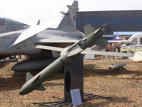

Also note in the 2nd pic, the A-Darter missile mock-up on the ground under the Gripen's wing - it's a rather fat missile, whereas the IRIS-T mounted on the wingtip is a rather thin missile for it's class.

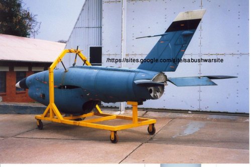

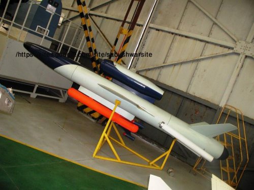

I posted without verifying.
Its probably actually a Teledyne Ryan Firebee target as the South African Air Force used those.
I was not aware of that Paul.
Do you have any further info on this?
Google didn't really reveal anything.
Where and when was the picture taken, SA Bushwar?
EDIT: The Friends of the SAAF Museum list a Teledyne Ryan Model 124 Firebee I which has a construction number of AF-83-0553 and a "previous identity" of 78022 listed in storage.
http://www.saaffriends.co.za/gallery/aeroplanes/museum_planes/list_of_museum_planes.htm
Picture taken at SAAF museum AFB Zwartkops, approx 2010, so it must be the item you refer to below.

It's interesting in that it is painted the same blue as most of the combat planes (Buccaneer, Canberra, Mirage and Cheetah) of the SAAF of the time, and not a hi-vis colour for target work.
As Paul says, if the link given above has the correct serial numbers, then this was a combat variant, not a target variant.
Quite intriguing, to say the least....
Any other pics of it SA Bushwar?

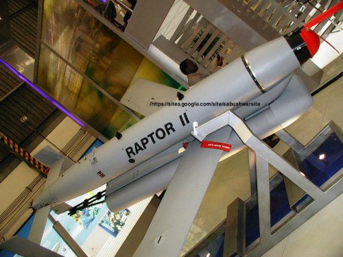

Maybe it was used for the development of the Raptor or Mupsow?

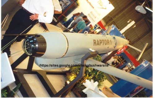

Raptor I, Raptor II and Raptor IID.

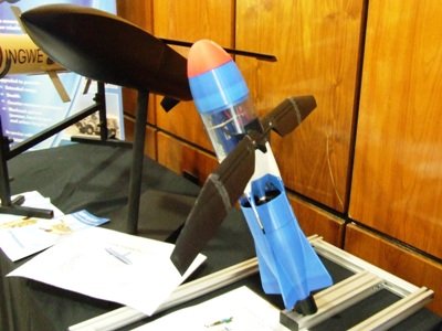

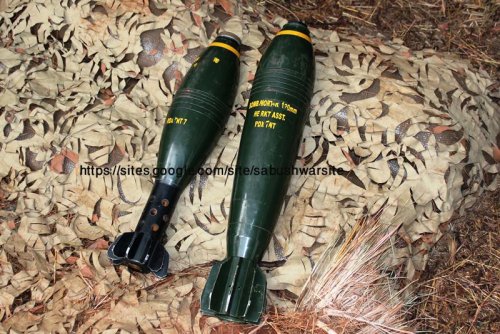

120mm mortar rocket assisted bomb. I understand this concept have also been extended to the 81mm and 60mm mortars?

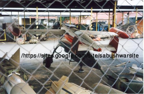

Does anyone have any backround info on the Skua target drone?
It has been mentioned in a book that the Skua was originally designed as a long range cruise missile, and was redeveloped into a target drone once the cold war ended.
Looking at the size and design, that makes a lot of sense.
Any history on the Skua would be most appreciated.
Do not have any history, but here is a 2004 picture, and a strange Skua lookalike mock-up at the SAAF museum at AFB Zwartkops

SA Bushwar, thanks for that pic of what looks like some sort of Skua type mick-up.
I wonder what the story behind that is?
Any further info?
Is it definitely something to do with the Skua, or is it something else?
EDIT: Nevermind, I see you said a type of "Skua lookalike". Be interesting to know what it is.

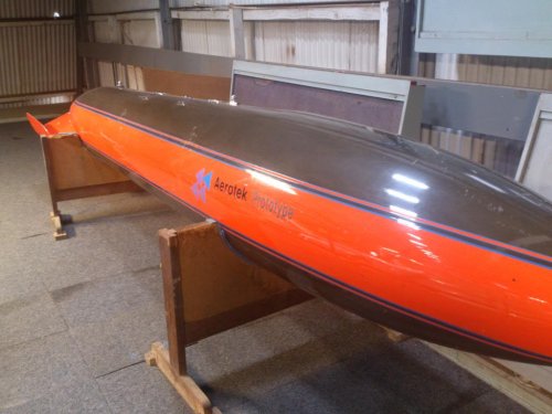

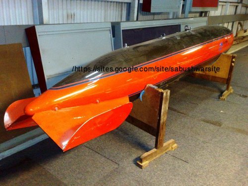

Looks like the big centerline drop tank for the Mirage F.1.
I seem to recall reading on the Saairforce forum that this was an indigenous project to replace the original aluminium Mirage F1 drop tank with a composite one.
I speak under correction though.
I think it was around the time of the All Composite Evaluator (ACE) and the composite fuel tanks and sponsons developed for the Oryx helicopter.
I'll see what I can find out.
I'm still interested in that mock-up of that winged cruise missile/target drone thingy SA Bushwar posted up a little earlier if anyone has any info...
SA Bushwar, do those displays have any information or name boards?
That tank above was an RP35 type fuel tank as used by the Mirage F1, containing 1200 liters.
This was a local project (CSIR) designed to manufacture a composite replacement of the original aluminium version.
3 prototypes were built, with the first being for structural testing. The next 2 prototypes were fully equipped and contained fuel and electrical systems.
I think this one above is the first prototype.
The project was actually to see whether new tanks should be constructed in aluminium or composites. Composites were selected due to a number of advantages, listed as including good corrosion behaviour with moisture and fuel, lower likelihood of suffering catastrophic structural failure due to a hostile strike, relatively low tooling requirements and cost for complex shapes, and greater scope to tailor the structural dynamics of the new drop tank to the original to prevent additional flutter clearance work.
Prepreg materials showed greater promise than wet lay-up systems, and weave was both plain weave and unidirectional.
